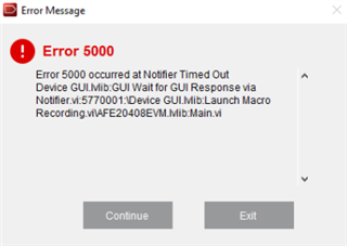

I am trying to launch the Scripting window by clicking Script -> Launch Window. I have Python 2.7 installed and added to system environment path. It gives me this error.

Scripting is unfortunately not available for this GUI. That is likely why the error is happening.

You can use the Low Level page to send specific register commands. To do more complex scripting, you would need to create your own code to work with the FTDI, or use the digital pins available on the digital header to work with the device directly.
