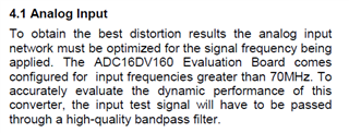

Could you kindly help to review how to modify this circuit to be used at 5-75Mhz input frequency?

I found the same question in another e2e thread: https://e2e.ti.com/support/data-converters-group/data-converters/f/data-converters-forum/278560/adc16dv160-eval-system?tisearch=e2e-sitesearch&keymatch=ADC16DV160HFEB#
Could you share the design file that joshua mentioned?

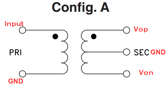

You can simply use the T1-1T transformer instead of the Anaren balun to lower the BW down within the frequency range for your application.

https://www.minicircuits.com/pdfs/T1-1T-KK81.pdf
Forgot to post the link to the transformer.

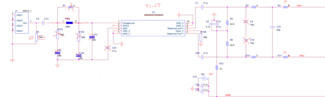

Can I simply connect T1-1T transformer as below without R/C changes?
And, will using T1-1T transformer affect ADC performance? such as THD, SNR?

Hi Kian,
Here is a good starting point. I marked up your schematic above.
You can play with the 22p DIFF cap to band limit and rolloff you need for your application.
