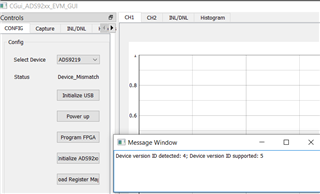

I recently purchased the ADS9219EVM and the TSWDC155EVM, and I downloaded version 2.0 (latest) of the ADS92XXEVM-GUI software from https://www.ti.com/tool/ADS9219EVM#order-start-development.
While following the ADS9219EVM user guide steps to get started, prior configuration steps completed OK, but the "Initialize ADS92xx" button in the GUI config tab (user guide section 3.2.3) reported back a "Device_Mismatch" status with a log message (see image below).
Digging into the python files, this message appears to originate from GUI_bridge.py and is related to a Version ID read command that checks one of the ADC registers. Haven't been able to find any info on this on the forums, and there is no ADS92XXEVM-GUI manual, only what's available in the ADS9219EVM user guide.
Interestingly, a colleague was able to successfully use what looks like an earlier version of the GUI received from the link on this post https://e2e.ti.com/support/data-converters-group/data-converters/f/data-converters-forum/1214830/ads9218evm-pdk-download-location-for-the-ads92xxevm-software-referenced-in-user-guide. However, that GUI only appears to operate correctly at a 4MHz sampling rate and is missing functionality that v2.0 has like reading out the internal temp sensor, so I would like to resolve this issue rather than attempt to work around it.

  • Hello Austin,
    Thank you for bringing this up. This message on this GUI appears due to the device not being fully released to market yet, but the GUI/device should still be functional, this message can be ignored.
    This GUI works with multiple EVMs and devices, some of those devices have been fully released and others not yet, like the ADS9219. Since this EVM has been released prior to the full release of the ADS9219, the marking on the device is also marked as “ADS92xx”. It is still functional as an ADS9219 though.  If the device on this EVM is replaced with a fully released device, e.g. ADS9218, the message should not pop up.
    In the other post shared for the ADS9218EVM the software had not been fully released yet and this additional step was needed.  I will also note the ADS9218EVM is now obsolete. Since then we have updated the both the GUI and both the ADS9219EVM and ADS9227EVM so that they are all compatible with all the ADS92xx devices.
