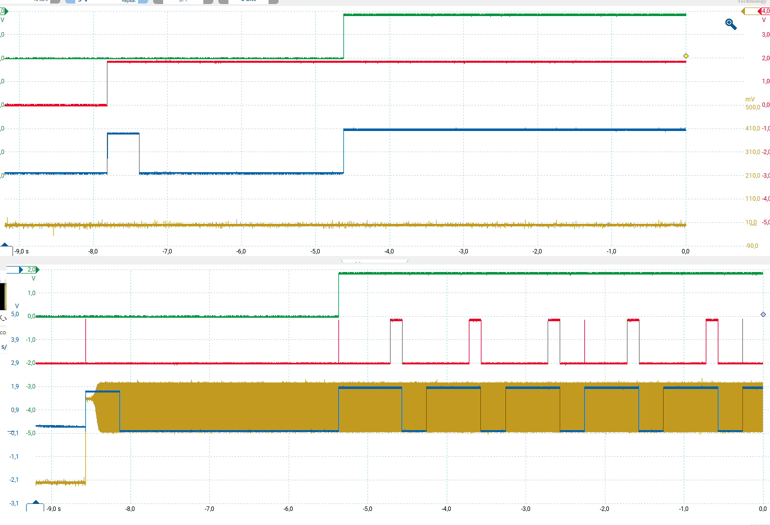

  • Joseph,
    Please look at the picture below. Does the first part look like the crystal is having a problem to start?
    GREEN      -> RESET
    RED           -> CD
    BLUE         -> RTS
    YELLOW   -> X1

  • Peter,
    It does look like the second device is not starting up. The oscillator is constructed like a Pierce oscillator, with a logical inverter at around the crystal, with capacitive loads on either sides of the crystal.
    In the diagrams, the bottom plot of yellow is X1, and the output should be oscillating between some lower to some higher voltage. In the top diagram, it looks like the X1 voltage is stuck low. For that to happen, I would have guessed that there would be no supply at the device.
    Again, I'm not sure what could cause that. I would have guessed that the supply wasn't connected. X1 at low, and I would guess that X2 is high. For the HART to operate, the device needs the oscillator to run, or none of the HART timing would work.

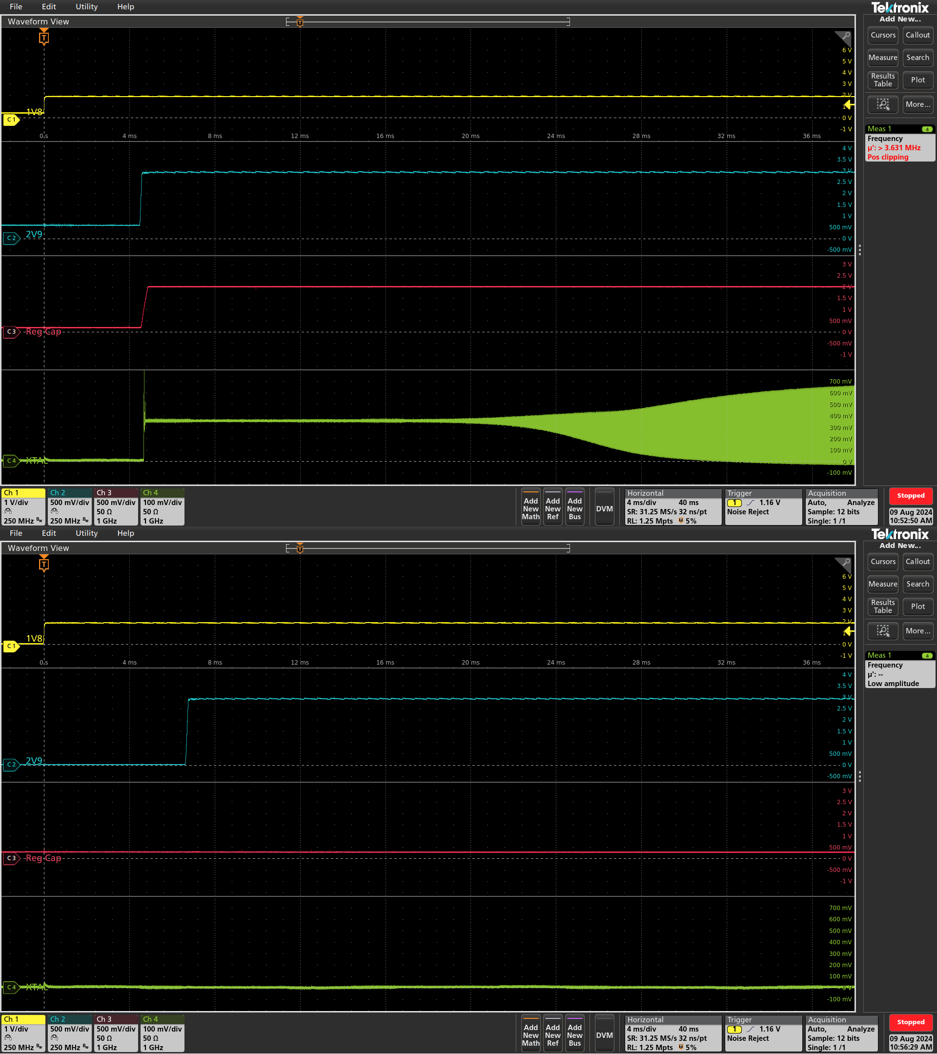

  • Hello Joseph,
    The previous picture top and bottom are from the same device. Here is another picture from that same device. Top part is where everything is working again normally and bottom is where the chip is not functioning. Check how the supply voltage is applied. In fault situation the Reg cap voltage is not starting to rise. If in the dead situation the 2V9 is removed and re-applied then the chip starts to work again. What is triggering or preventing Reg Cap from rising? What else can we do to debug this issue?

  • Peter,
    At this point, my best guess is that the initial load from the CAP combined with another internal load from a lack of AVDD from the is causing a start up problem. I would expect the latter two results (where suppling an external 1.7V supply to REG_CAP, and lowering the capacitance of the load) to help the start up, which is why you don't see the issue. I would not have expected a parallel 100kΩ resistor to help.
    It does seem that lowering the REG_CAP does help. I would also expect that adding a tiny series resistance with the load cap would also help. You can try adding a 1Ω series resistance or using a tantalum capacitance may remove this problem. For many ceramic capacitors, the ESR (equivalent series resistance) may be exceedingly small. The internal LDO in the DAC8740H may have a problem starting up without the AVDD.
