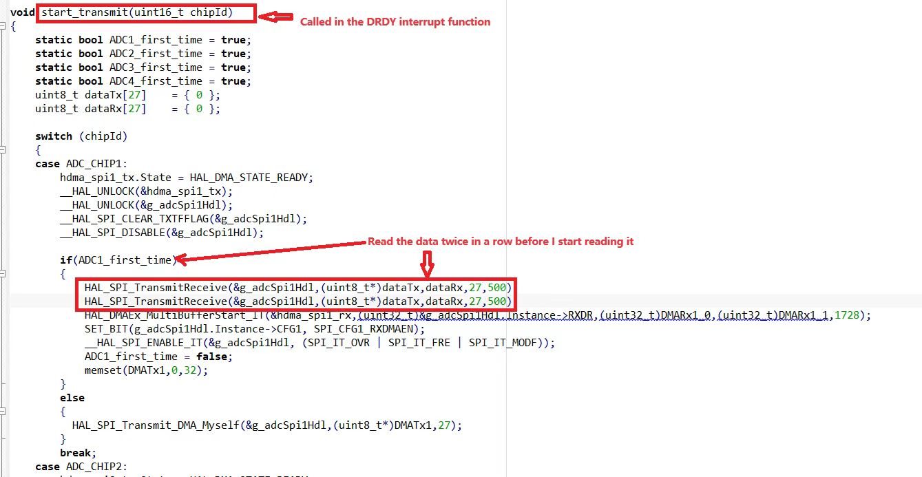

Recently I ran into some issues while debugging ADS131M08. Some features of ADS131M08 are not well understood.
My project is to use STM32H7 as micro control, SPI+DMA way to read data.
Following the instructions in the data sheet, two consecutive frames are read before DMA is enabled. Why read two frames in a row first? I didn't do what the manual said, so DRDY no longer behaves at the rate I set. For example, I set it to 8KSPS, but the actual performance rate is less than 1K.
I actually want to know the detailed mechanism between the behavior of the DRDY pin and the 2 'FIFO inside the device. ”

  • I read the ADC data by detecting the behavior of the DRDY pin. That is, whenever a DRDY interrupt occurs, I will enable SPI Tx DMA to send NULL commands, while SPI Rx DMA is also enabled. Below I will share the timing waveforms of SPI CLK and DRDY lines under normal and abnormal conditions. It can be seen that the DRDY frequency in the normal case is 8k and the DRDY frequency in the abnormal case is 249Hz

  • I read the value of status register (0x01) and it is 1280. The ADC conversion value I read is unstable and feels inaccurate. Below is my code.
  • Hi user4637774,
    The default data of the STATUS register should be 0500h. The wrong data you got indicates your timing is incorrect. Let's correct your timing first by reading internal registers.
    Below is a timing example to read Gain register (04h address) in the first frame and the response 0x0E0E register data which was previous programmed is shown in the 2nd frame, can you please capture a similar timing with your circuit board and software? you can read the default data from some registers (e.g. CLCOK or CFG register) after the ADC is powered up. Your schematic will be helpful to debug too.
