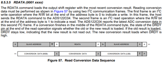

  • Hi Bjorn,
    The I2C flow (reset chip, writing to the configuration register 1 to enable temperature sensor mode, start conversions, read conversion data) mentioned seems correct, make sure you are following the read conversion data sequence (shown below) stated in the data sheet properly.
    I can't comment on your terminal communication.
    What I would recommend is using a logic analyzer or an oscilloscope to monitor the digital communication when you issue your I2C commands.
    This helps verify that the digital communication looks correct as stated in the data sheet, or if there are problems with the way your I2C communication looks.
    This is what the I2C sequence should look like to read data from the device after setting your configuration (enable built-in temp sensor) and starting the conversions:

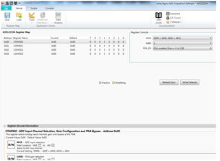

    The GUI will allow you to select your configuration and display data captures without having to write your own code for evaluation purposes.
    Here's a capture from the GUI where you can choose your parameters such as mux selection, gain, data rate etc.
    If using your own controller/code, write to the appropriate registers through the I2C commands to set the gain and relevant parameters. Information on what to write to the configuration registers to set your desired parameters is available on section '8.6 Register Map' of the data sheet.
