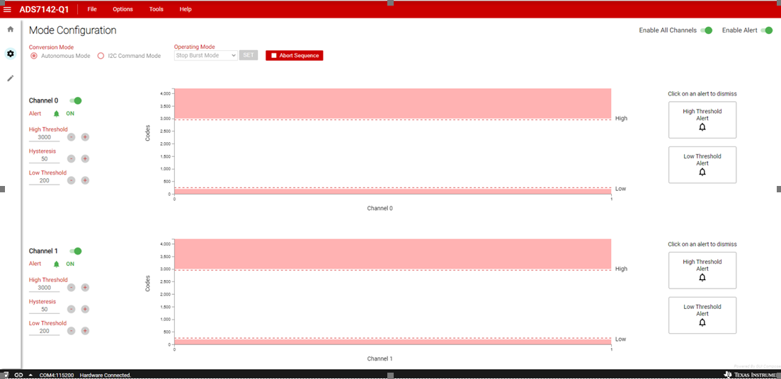

I have a customer who is using the ADS7142 2-Ch ADC and having some issues with the GUI interface in the Autonomous Mode. The customer's problem is lined up below:
"I selected it for an I2C based 2-Ch ADC with seemingly ease of integration.
However, I am having some difficulties with the GUI.
Our main use case would be the Autonomous Mode, in the Stop Burst mode (this way we can just go and read the sensor when we want and get the last 16 samples)...however, when I try that in the GUI, I get no data samples at all... My chart is just stuck at sample "1".

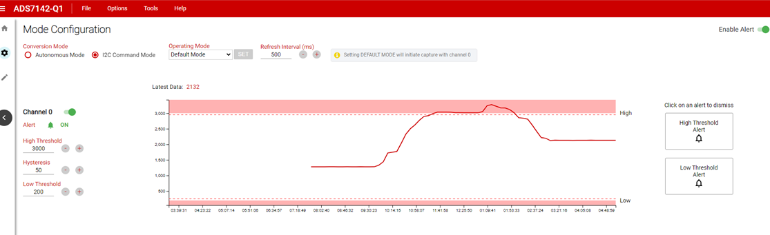

If I switch to I2C Command (Manual mode) I get my data charted nicely every 1/2 second (I am using a simple trim-pot resistor divider to create my waveform):
Is there some trick I am missing in the GUI to "start" the samples in Auto mode?

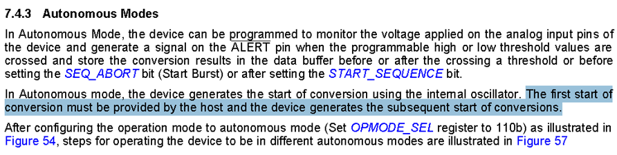

I see in the spec the following statement:
but is the GUI supposed to do that? It almost seems as if the "START SEQUENCE" button is not working to start in Auto modes.

  • I'd like to add a few follow-on questions about the GUI:

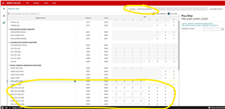

    1) Does the register pane even do anything? I never see it update and the values I enter in the gui panel never seem to reflect on the register page, even with updating "as fast as possible"
    Here we can see values set for thresholds, but the register contents are always 0x00

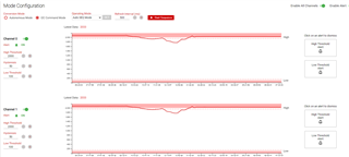

    2) How do I get the alert functions in the GUI to work? They never do...
    Here we are clearly well above the PRE_ALERT_EVENT_COUNT (which is zero) and the ALERT never triggers:

    After trying this on my board, I can verify that I am experiencing the exact same issues that you are running into. I am updating the thresholds in the GUI, but it does not send anything over the I2C bus, so doesn't change the registers. If they are set in the register page, it does update the flags in the registers, but has no effect in the GUI.
    Unfortunately, this seems to be an issue with the software that the GUI is running on, so there won't be an immediate fix for this. I will send an update in case we're able to get an update on this. I apologize for that.
