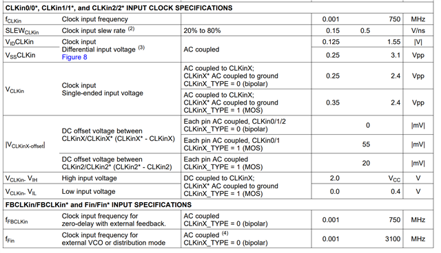

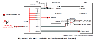

I am confused -Refiring to ADCxxQJxx00EVM data sheet - the input to CLKIN1 (see image) can be between 500-1600Mhz input.
The data sheet of the LMK04828 claim max input clock to CLKIN1 pin is 750Mhz.
what I do not כשןך אם understand?
I want to work with 1Ghz clock.

  • Hello Giora,
    The LMK04828 is only configured for distribution mode, not clock generation mode. These two modes have different input clock ranges, please see the screen shot below
    In the bottom box we can see the Fin in distribution mode is actually 0.001 MHz to 3100 MHz, which will support the clock speed you want.
    Eric
