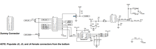

I want to use ADS1299 to develop EEG devices. So I bought ADS1299EEGFE-PDK, which I think is easier to use. I want to control it with STM32 processor. I would like to ask, is it feasible to connect the test board to MMB0, powered by MMB0 and controlled by stm32?

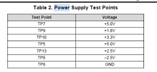

But I seem to have encountered some problems and I am troubleshooting. I can't read the default register value of ADS1299 on the test board through SPI instructions. I'm not sure if I damaged the board. I want to know if there is any way to verify that the board is intact? Can I judge whether the board is intact by the voltage of these TPs?

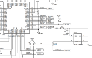

Also, I want to know, when I want to use the 2.048Mhz crystal on the ADS1299EEGFE-PDK board, how should I set the jumpers JP18 and JP23?
The JP18 should be 2-3, JP23 should be 1-2?
But in the circuit diagram, if JP18 is connected as 2-3 (The middle and lower terminals of the three terminals), does it mean that EXT_CLK is used?
And I also want to know, ADS1299 is using internal crystal, crystal on EVM, or external crystal. Will different crystal frequencies affect SPI communication?

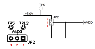

  • In addition, is there a better way to distinguish the corresponding relationship between different jumper connectors, especially when there are three connectors (such as JP18, JP21, JP22, JP23, etc.), how to tell which is 1, 2, and 3? Because some of them are horizontal and some are vertical, which makes me feel a little confused.

    3. The ADS1299 can still be used with an internal or external oscillator. The selection can be made via JP23 ([1-2] = external, [2-3] or OFF = internal).
    FYI - in the schematic, the "rounded" corners of the header schematic symbol indicate pin 1. On the PCB, pin 1 is denoted by a square pad, while the remaining pins feature a circular pad.

    Channel 0 is CS, channel 1 is SCLK, channel 2 is MISO, and channel 3 is MOSI. Do they look normal? I don't know if it's because the ADS1299 EVM is damaged, causing the SPI transmission to be unable to read its register values. I measured the voltages of the corresponding TP terminals in the user manual, and they look normal. Is there any way to detect whether the ADS1299 EVM is damaged?
