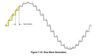

I am interested in the DAC63004 smart DAC. I have been reading the datasheet trying to figure out how to output a sine wave for a certain frequency. From what I understand there are hard coded slew rate options that allow you to set certain frequencies. My question is what if I want an output frequency that is not one of the pre-fixed frequencies? In the datasheet it says:
"An external RC load with a time constant larger than the slew-rate settings can be dominant over the internal frequency calculation."
Does this mean that I can add an external RC load to set the frequency I want?
