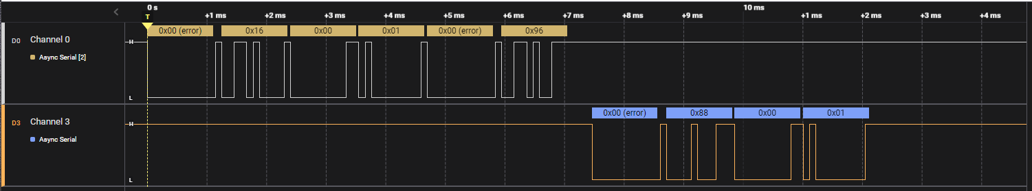

I have connected MSPM0 with AFE781H1 device. For confirmation, I am doing giving command for  "internal oscillator to be driven on CLKO pin".
However looks like there is a configuration error and don't see CLOCK signals on the CLKO pin.
My code is as per below:
set_register_bits(CONFIG_ADDR, 0x0800 | 0x0060);
write_register(DAC_OUT_2, 0x1234);
uint16_t data = read_register(DAC_GAIN_ADDR);
data = read_register(DAC_OUT_2);
Can you suggest from waveform if any bit stream is incorrect.  I am using UART in 9600 baud rate.

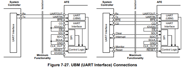

    I would test the UART Break communication with both a write and a read just to check that the device is listening. However, I would start by checking the digital connections against Figure 7-27 in the data sheet:
    Then you enter UBM mode with a write of 0x00 0x01 to the 0x16 (UBM) register. This should get the device into UBM mode, and I think it automatically sets the device to 9600 baud. Then you can read the register back. I took the following from a transaction that I found in another post that shows a write and a read. The write starts the device in UBM mode, and then the register is read back:
    Using both write and read, you can at least verify that the device is receiving the data.
    Joseph Wu
  • This helped. Additionally, there were some transaction on the SDI pin, that was causing problem.
