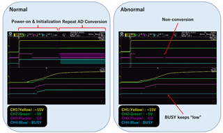

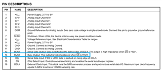

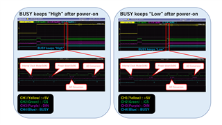

ADS8341EB may not work normally after power-on. The symptom is that BUSY keeps low and AD conversion cannot be performed. This is a malfunction in a product that is actually being used on the market. Especially, even when using the same board and the same component, the incidence of this symptom increases when Ta is 50°C or higher.

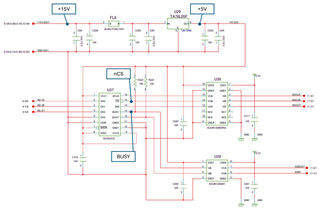

Have you had any experience with this in the past? Could the power supply ramp-up speed or input terminal handling cause a malfunction?
The schematic and the screenshots at power up are as follows.
Could you please give me any comments?
