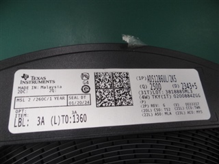

We purchased this part from TI shop ,but find the topmarking is ADS, 1286U   lost a letter  "L" as your datasheet writtien
could you help check this difference ,and why ?

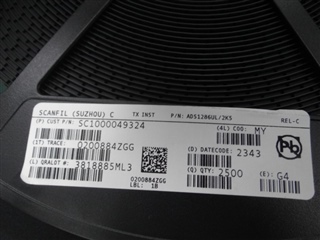

    Thanks for your answer , but the fact is that you shipped the correct MPN on label ;  please find the attached pictures
    Just the marking is not met your spec of datasheet , so please help double check this

  • Hello Zhang,

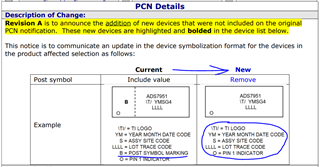

    Sorry for the delay here. We are able to confirm, based on the information in the pictures you sent above, that the material is the ADS1286UL even though the marking does not match. We are working to confirm why the symbolization is not correct. We believe a PCN (Product Change Notice) may have been sent out explaining that the symbolization on the material would change. Once we identify which PCN has the information I will send it to you.

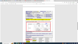

  • Hello Zhang,
    Here is the PCN where we outlined that the top marking of the device will be changed:
     ADS1286UL PCN.pdf
    Josh
  • hello, i checked your PCN ,but i am not clear the changed information , seems not related my question;   the marking "ADS1286U " currently we purchased type in not matched your spec in datasheet "ADS1286UL"  ,  so could you help double check it ?

  • Hello Zhang,
    in the PCN the "Post Symbol Marking" is removed in the new markings. This is represented by the notation B in the left side of the picture you sent. In the right side of the picture the letter B is removed. Unfortunately the picture in the PCN does not do a good job representing where the post symbol marking would normally be placed on the topside marking.
    Let me know if this answers your question.
    Josh

  • Hello Zhang,
    Yes, I Understand the question you are asking. The letter "L" was removed from the topside of the device per the PCN I have sent over. If you notice in the PCN on the left side of the image (underlined) there is text describing a "POST SYMBOL MARKING". On the datasheet and previous iterations of the topside marking this marking was the letter "L". On the right side of the PCN image the "POST SYMBOL MARKING" is removed meaning the letter "L" is removed from the topside marking of future manufactured devices. The datasheet was not updated, but the PCN explains that the letter "L" was removed from the ADS1286UL/2k5.
    Let me know if you have any other questions.
    Josh
