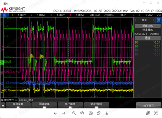

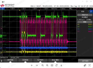

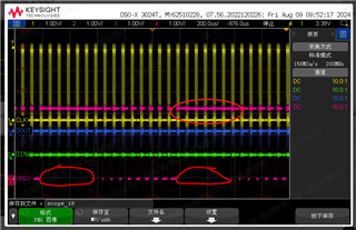

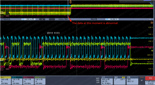

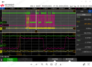

Next,I sent a  RDATA command in the 15KHz EPWM interrupt function, and sent the remaining 216 SCLks to read the data of eight channels. The CS pin was kept low throughout the process. Because the interrupt frequency of 15K is asynchronous with the set sampling frequency of ADS131E08, there will be a phenomenon that the DRDY event overlaps with the reading data clock SCLK, but the manual says that it will not cause data corruption, which can be seen in the actual test.
Oscilloscope waveform:
1-> SCLK; 2->DOUT (MISO); 3->DIN (MOSI) ;4->DRDY

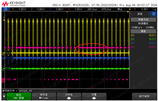

Data corruption occurs at the following moments:
We did a test on related data errors time, and the test method is:
1、 Only the upper 8 bits of channel 2 data (the upper 8 bits of 24-bit data) are read, because the input of channel 2 is about 1.5V If the data changes suddenly, the upper 8-bit data will change. The difference between it and the above configuration is: SPI Polarity 1, phase 0.
2、If the high 8bit data will change, pull up the CS pin and grab the oscilloscope waveform through it.

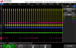

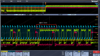

Waveform at normal time of data: 1: CS; 2、SCLK; 3、DIN (SIMO) ; 4、DOUT(SOMI)
Normal data high 8 bits 0011111 :
High 8 bits of data at abnormal time 011111 :
Finally , Does the DRDY event really affect data reading when using the single conversion instruction RDATA?
We want to know what the problem is. Looking forward to your reply, thank you!

    Also, use the scope and monitor the DRDY line; this should be toggling at the expected data rate of 16kHz.  Please also provide a picture of the schematic showing all pin connections to the ADS131E08.
    Using the RDATA will always readback valid results.  However, if you are not reading data fast enough, then you will simply miss conversion readings, but the readings you get will be valid.  From what I can tell, it looks like you may still be in the power-up default RDATAC mode.

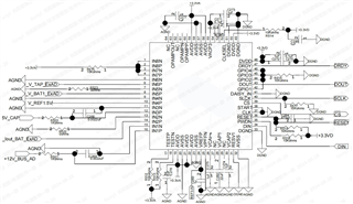

    The schematic design used is as follows:
    At the beginning, the SPI mode used was also SPOL=0 and SPHA=1, but communication could not be established normally. However, using SPOL=0, SPHA=0 or SPOL=1, SPHA=0, communication can be established normally.

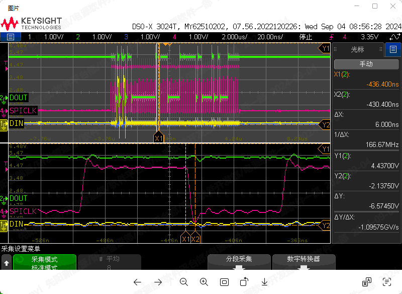

    The schematic looks O.K., you should be able to read conversion results from the ADC.  However, it is very important that the bypass capacitors are placed very close to the supply pins on the part.  For best performance, we recommend individual bypass capacitors for each power supply pin on the ADC.  I these capacitors are not close to the ADS131E08 package, you could have unpredictable operation.

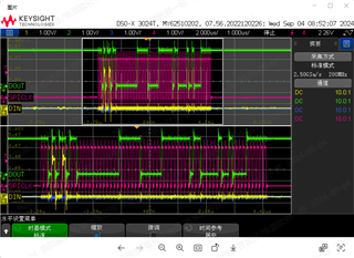

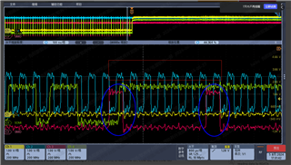

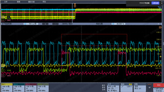

    Please capture the first part of the SPI frame that captures data.  Just capture the first 56b (SCLKs), which include the RDATA command, STATUS word, and the channel1 conversion result.  Include 1: CS; 2、SCLK; 3、DIN (SIMO) ; 4、DOUT(SOMI) as before.  I would like to verify that the timing is correct.  Also, when you capture this data, please provide a constant input voltage and let me know the value of the voltage to see if the conversion results are correct.
    Also, looking at your previous waveform capture, the DIN (SIMO) has activity on it, circled in BLUE below; the DIN should be low during channel data readback.  The only time there should be activity is during the first 8 SCLKs of the SPI frame when sending the RDATA command.
    Keith
  • Hello,Keith Nicholas

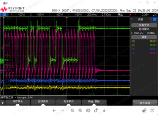

    The SPI configuration is set to 16 bit mode, and the ADC configuration is set to 16KHZ,Polarity 0, phase 0. The following figure shows the 64 bit data of the SPI frame, including the RDATA command, STAT3 word, and the conversion result of channel1. The data for channel 1 is 1.5V, and the external benchmark is 3V.
    In addition, during the data retrieval period, DIN is not at a low level because the amount of data is too large. In order to facilitate data reading, DIN is assigned a special value and avoids command words. The measured data does not seem to be affected by this factor.
  • Hello Zhang,
    It appears from your scope plots above that you are using f-SCLK=20MHz.  (4 SCLK periods in 200ns).  Since it is hard to tell if setup and hold times are being met, I suggest reducing F-SCLK to a much lower frequency, such as 8MHz, to rule out any timing issues.
    Also, when reading data from the ADS131E08 using RDATA command, I suggest you keep DIN low after sending RDATA (12h) for the rest of the frame.  Even though you are not sending a valid command, the ADC still must process the data, and if it is an unexpected value, you may get unexpected behavior.

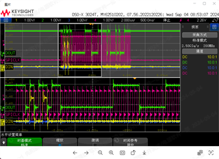

  • Hello,Keith Nicholas,
    The following figure shows that the SPI rate is 8MHz, and everything else remains the same as above. In fact, we have tried reading data at a lower rate and obtained the same result.
    In practical use, after sending the RDATA command, we lower the DIN, but the result is still the same.

  • Hi zhang qiu,
    In the image below that you sent previously, you can see that DRDY stops toggling during the time you said you were receiving "data corruption". If DRDY stops toggling, this means the ADC is no longer converting, or at least that the ADC has restarted the conversion process.

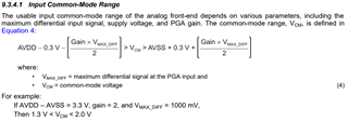

    Also, you mention that the signals you are measuring are single-ended:
    The hardware interface is that the power supply AVDD = 3.3V, the internal clock of the chip is 2.048MHZ, and the single-ended signal is input with (CH1~CH6).
    Note that the ADS131E08 cannot measure single-ended (ground-referenced) inputs when using a unipolar supply (AVDD = 3.3V in your case). This is evident by equation 4 in the datasheet, which I have copied below
    -Bryan

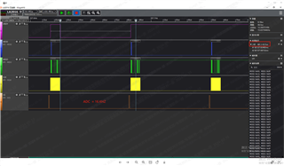

  • Hello  Bryan,
    We use the first and second points you mentioned, and there will be exceptions when reading data. But based on the third point you mentioned, we have adopted a DRDY peripheral interrupt method to read data, and the data is normal, which can avoid the occurrence of data anomalies.

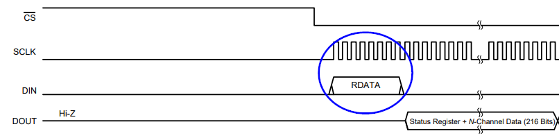

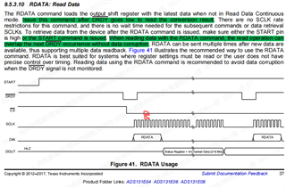

    However, according to the manual instructions, using RDATA command should not require checking DRDY, that is, it can read data asynchronously. However, the actual phenomenon conflicts with the manual. Therefore, should we use RDATA to determine whether it can perform asynchronous operations (here, asynchronous operations do not require checking whether DRDY has changed, that is, normal data can be read at any time).
    Our question is: Is it an error in the manual instructions or is it due to our incorrect use of the RDATA command.
    In addition, the relevant instructions in the manual are attached below:

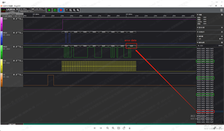

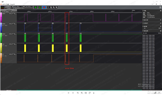

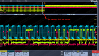

    We used a logic analyzer to capture abnormal data waveforms, where the timing met your requirements for the first and second points, but the third point was not met (because we wanted to verify whether our question was correct). Among them, only 64 SLCKs were read, and the last byte (0x3F) is the highest bit data of channel 1, where 0x3F is the correct data.
    At the same time, we captured the highest bit data of channel 1 at the time of DRDY signal overlap. According to the analysis of the logic analyzer, the data (0x5F) is abnormal, which indirectly confirms our hypothesis (DRDY overlap does affect the correctness of the data, and the manual indicates an error).
    We just need you to confirm whether our hypothesis is correct.
    The image of the logic analyzer is as follows:
  • Hi zhang qiu,
    It seems like there is an issue with the command being sent just before, during, or immediately after (a few microseconds) of DRDY toggling high to low. So this is not an issue with the data per se, but the command. This is effectively stated in the datasheet, but it could be worded more clearly.
    Since you are sampling asynchronously, eventually this condition will occur and you will get bad data. This e2e posts hints at this issue: https://e2e.ti.com/support/data-converters-group/data-converters/f/data-converters-forum/615552/ads131e06-corrupted-data-with-rdata-command
    My recommendations for your system:
    1. Keep DIN low the entire time you are clocking out data. I know you said there were no issues so far, but there definitely could be in the future. You do this at your own risk
    2. Toggle CS before and after data read back. Tying CS low is possible, but not recommended because there is no way to reset the SPI interface without toggling the RESET pin (or powering up/down the ADC). However, it should work
    3. Use DRDY as an interrupt to determine when to read data i.e. read data synchronously to DRDY. This will avoid the RDATA command shifting in time, and eventually "colliding" with the DRDY toggling high to low, which causes data corruption
    -Bryan
