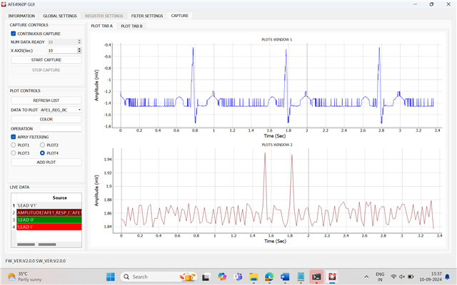

Hi, I am using AFE4960PEVM and related biosensing software to visualize Lead 1 configuration ECG waveform. The wave forms are created using a simulator. I followed the instructions as per "Design Example – 5-Lead ECG Pg 249" from the AFE4960P datasheet. Both the plots/channels of AFE2 shows only noise in the graph. While AFE1 graph shows appropriate wave form as per configuration. I suspect AFE2 isn't working as I could see the wave form of lead 1 if I configure the AFE1 registers to process the LA and RA electrodes. I am using the stock py script provided by the bio sensing software and verified the values as per the "Design Example – 5-Lead ECG Pg 249". What else should I do to, in order to make the AFE2 work?

  • Hello Aswatch - I cannot access the picture in the link you shared. Can you please attach the image directly to the post?
    Yes, that is the same python script which I mentioned. I will review this again this afternoon.

  • I hope this image is clearer. I couldn't attach the original image, had to compress for the reply box accepts the image. Just in case if you find the image has poor quality. Please check the following sites:

  • Thank you, Aswath. This image is perfectly fine. We will review and provide feedback shortly.

  • Hi Ryan
    "This is Nandy, posting on behalf of Aswath with a query related to Dual AFE. On activating the Dual AFE, I encountered an error and warning saying 'reset property not found' when trying to collect data using the script you mentioned earlier. I have also attached screenshots of the warning message, and the waves generated by the script."

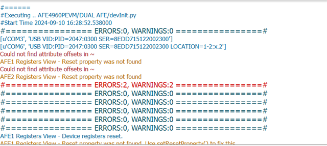

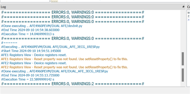

  • Hi Nandy,
    Thank you for the update. You can ignore the yellow warnings about "Reset property not found."
    Since you are flashing the dual-AFE firmware from the AFE4960-DESIGN folder (non-"P" version), I'm wondering if there's some dependency in the GUI. Please follow the steps below:
    1. Unplug EVM and close Bio-Sensing software
    2. Install the latest version of AFE4960EVM software (v2.7).
    3. Plug in EVM and run Bio-Sensing GUI
    4. From AFE4960EVM profile, run "devInit.py" and "DUAL_AFE_3ECG_1RESP.py" scripts. You can create a new script and paste the script I shared previously instead if desired.
    Also, don't forget to change the positions of V1 and LL as I pointed out in my previous post.
    By the way - does your Cardiosim III have respiration functionality? I tried to verify this on the Biometric Cables website and I do not see this feature listed. Therefore, you will only be able to validate the 3 ECG channels in this script.
    Ryan

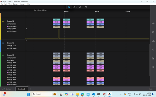

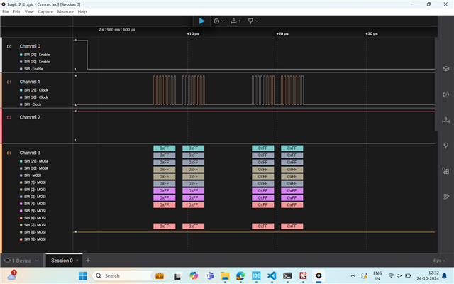

  • Hello Ryan,
    Yes, at first Wrong data being recorded when reading register (random R/W register for testing purpose). my transmitted hex value was 0x400000, and I received 0x404040. But now the received data is 0.
  • Hi Ryan,
    we have been trying to capture ECG and RESP data by interfacing AFE with stmf746 Disco. But, when i read any register, the received value will be 0xffffff.i have configured the register bit values based on datasheet and DUAL_AFE_3ECG_1RESP.py script. i have also applied 50 microseconds of delay (by timer) for hardware reset on RESETZ pin and initialized AFE as per the sequence mentioned on 266 of datasheet. I have Attached AFE.c file. the function name with test where am reading the written data from register.
