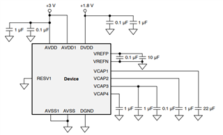

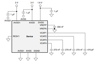

ADS131E08: will it work with ADS131E08S capacitors.
Part Number: ADS131E08
Will the ADS131E08 work with capacitors values which were adjusted for ADS131E08S?
The 3ms startup is not used in based aplication with ADS131E08S.
  ADS131E08
 ADS131E08S
Bonus question: Can the reference voltage (VREFP) be connected between two parallel connected ADCs (ADC is configurated to select internal reference)?
