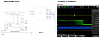

Hello Experts,
We are developing a sampling board.
We get rx_lane_valid signal are transition from ‘1’ to ‘0’ once about 15 minutes on our board.
At this time, IP-Errors has occurred.
IP-Errors are "rx_lane_invalid_somf_err_count", "rx_lane_invalid_eomf_err_count", "rx_lane_notintable_err_count" and "rx_lane_disp_err_count".
Could you give me some advice on what could be the cause of the error?
ADC: ADC09SJ1300、1250Msps、JMODE11(4Lane, 9bit, 8B/10B)
TI-JESD204C IP: Release-v1.10-LATEST
FPGA: xa7z030fbv484-1Q
