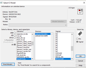

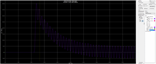

I"m attempting to use an LMX2615 device to feed the CLK_N/P and SYSREF_P/N of the ADC12DJ5200-SP.
We're doing LVPECL and I'm getting a waveform that doesn't seem to meet the Specs called out in the Electrical Characteristics for the ADC.  Can you provide an example waveform for me to compare?
