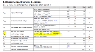

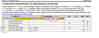

1) Kindly confirm that the voh/vol from below table is valid for output signals only (SDO, CALSTAT, ORA0, ORA1, ORB0, ORB1)
2) And Input signals (SCLK, SDI, SCS, PD, CALTRIG, SYNCSE) will have to follow below table
3) are max vih, max voh on these pins 2V?
