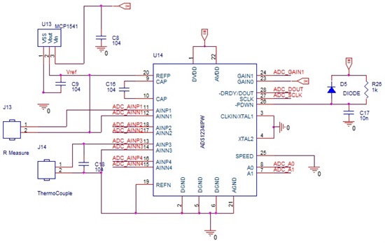

I'm using ads1234 and see its operation is weird. I did connect the part as follow: both XTAL1 and XTAL2 to 0V, SPEED to 0V,t PWDN to VDD via RC network (1kOhm and 10nF), all digital pins (SCLK, GAIN1, GAIN0, A1, A0) go to 0V.
As I see waveform on DRDY/DOUT pin on my ossiloscope, the pin pulse low to high to low every 11ms, pulse width is 4.2 us. I suspect this is 80 SPS mode but the hardware is in 10 SPS mode? The results retrived from adc is random and unstable. As I turn on and off the board, sometimes (about 10% of all cases), the pin pulse low to high to low every 100ms and the result is correct.

    Mr Bob, thanks for your quick reply.
    I designed a 2-layer PCB for my project and just used copper poured ground, not a seperate ground layer. I attach here the schematic and layout of the board.
    AGND and DGND are all connected to 0V. I'm not sure if the impedance is low enough, how low is needed? Also, I don't think the incorrect results are caused by grounding because I didn't get any stable bit in them, all 24 bits change with time.

  • T.ahn,
    I'm sorry that I didn't catch this earlier.  Your RC values are incorrect.  You need at least a 2.2nF cap at the power down pin.  Note page 23 of the datasheet and the Power-up Sequence section and the figures 39 and 40.  There must be a minimum of 10us from AVDD fully high and the PDWN pin going high.  With the shorter delay time the power up reset conflicts with the reset that happens with the PWDN pin going high.  This places the device in a conflicted state.

    Figure 40 shows a known working RC circuit.  If you lower the value of C, you must also increase the value of R so that the time constant remains the same or longer.

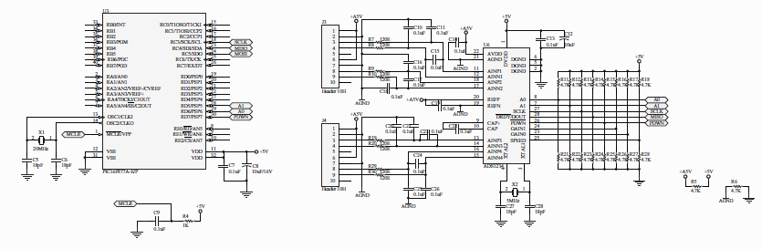

    I am using PIC16F877A microcontroller with ADS1234.
    I tried your suggested both option, but I can't get DRDY Pin Low in any condition.
    I also replace ADC but same result as, not get.
    I also short Crystal both pin to Ground but same result as, not get.
    what exastly problem I can't understand?
    pls let me suggest test procedure of ADS1234 in sequence.... what I do??
    Is there SPI module enable require in micro controller?/
    I attached herewith my schematic..
    Pls help.
    Jignesh
  • Hi Jignesh,
    I think the best thing to do at this point is to replace R5 and R6 (4.7k resistors) with 0 ohm (direct short).  There should be a low impedance connection between the AGND and DGND of the ADS1234.  Also, you will starve the analog portion of the device by restricting the current to AVDD.  If you want to add some filtering, try 10 ohms at AVDD, but in no way should you add any resistance between the grounds.

  • Respected Sir,
    sorry for the wrong value(by mistake) in the schematic, correct value of R5 and R6 are 0 ohm, I think all condition of my side is good as per schematic.

    Also, I can't tell if you have used the correct pins for your schematic symbol as the picture is not clear enough to show me the detail to read the pin numbers.  Make sure your symbol matches precisely with the datasheet pins.  Also make sure that the footprint you are using for the PCB also matches correctly.
