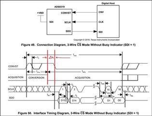

ADS8319: min set-up time for CONVST deassert after conversion time
Part Number: ADS8319
In 3-wire CSNOT configuration without Busy Indicator, there doesn't appear to be a minimum time listed between the end of CONVERSION and when the CONVST signal (equivalent to chip select) can be de-asserted.
Is there a minimum set-up time for the CONVST signal after tcnv has elapsed?
