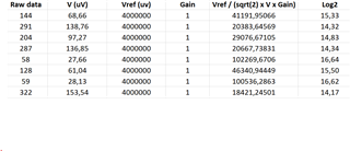

    Thank you for your response. The data I provided is in raw form, not converted to voltage. When I convert the raw data to voltage and calculate the ENOB, the results range from 14 to 16 bits, rather than 21 bits.

    I understood your data are raw data, not voltages. If you look at the equation I provided for calculating the ENOB, you should calculate the RMS noise from a batch of data first, not a single code, then you can calculate the ENOB.

    As I mentioned earlier, the measurements are stable, and I'm not focused on measuring noise. However, I want to understand why there's an error in the measurements, as it appears that I am using a 16bit ADC. For example, on channel 8, I get a reading of 322 instead of a value closer to 0.

    You are right, the calibration process will set the ADC to 1-ksps, thanks for pointing it out. Let me clarify your 'concern'. After the DR[2:0] in the CONFIG1 register is set to 110, the ADC works in 24-bit mode, so
    • 1LSB = (2 × VREF / Gain) / 2^24 = (2 × 4 / 1) / 2^24 = 476.8nV.
    • Before the calibration, the voltage for -954 code= -954 × 1LSB = -454.8uV
    • After the calibration, the voltage for 322 code = 322 × 1LSB = 153.5uV that has been 3 times lower than the voltage before the calibration, and also it is lower than the typical Voffset = 350uV.
    ADS131E08 only collects 16 data points for the calibration. You could do an additional calibration by collecting more samples and averaging them in your software on your CPU, but a code closer to 0 should not be expected.
