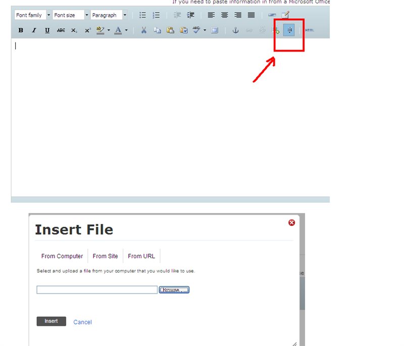

    I'd like to show you what the circuit looks like just for confirmation that I'm taking the right appriach, but how do I upload a file associated with this thread? It would be in the form of a pdf file.
    Dave
  • Hi David,
    I will review the circuit.  To attach/post the pdf file, you may click on the "insert file" button on the tool bar; a "Insert File" window will appear asking you to browse for the pdf file on the computer.  Please see below.
    Thank you and Regards,
    Luis
