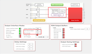

Apologies for the delay, we were out of office last week due to the holiday. Yes, the design team has informed me that for the FS/4 mixer mode, the DDC block must be configured for COMPLEX deciamtion, but the output interface msut be configured as if the device were in REAL decimation mode. So, here are the steps required:
1) FCLK = 61.44MHz, DCLKIN = 123.88MHz
2) Configure the ADC for 16-bit, 2-wire mode, complex decimation by 4. Configure the sample rate and NCO frequency.
3) Enable FS/4 mixer
4) Configure output interface to real decimation mode. According to configuration table 8-9 in the datasheet, the following is needed for 16-bit, 2w, real decimation:
You can configure the FCLK source and FCLK divider in the GUI here:
Set FCLK source to bypass and FCLK Divider to by 2. You should get an FCLK of 15.36MHz.
5) In HSDC Pro, use the ADC3660_2W_16bit_CMOS option, and ensure that you set your data rate to 30.72MHz, as the output data rate is now doubled. (FS/dec factor) * 2

I was able to get it to work as I had thought.
Finally, we are now set up as shown on the screen with the following conditions.
Please point out any errors.
Configuration
ADC SAMPLINGRATE Fs=61.44MHz
Decimation Setting:8
# of Wire:2
Out put resolution:16bit
Output Bandwidth:7.68MHz
FS/4 Mixing with Real output
Hi Miyahara san,
Everything looks correct from what you have sent me. I am glad you were able to capture data. I am going to go ahead and close this thread. If you need help with anything else, please feel free to creade a new thread.
