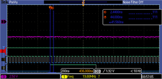

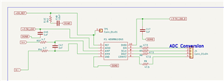

I am using the FPGA get the sampled data. I am using a 3-wire operation and so far I have taken everything from the data sheeet .
Sclk :- 25 MHz (40 ns).
Time between conversions :  Well beyond 1000ns.
Acquisition time :- 640 ns . (well above the limits of min acquition ).
Attached are the waveforms below .
Waveform 1: The bottom on is the convst signal . The middle one is the Sclk . and the one above it is Din (Constant high at 3.3v). Pink one is the input wave which is to be sampled.

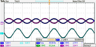

Waveform 2:
Its shows the time between conversions are also good .
