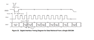

Hello, I have created a new PCB board with MCU and DDC264. I wanted to establish communication via SPI and start reading data. Currently, I want just only check that my design is correct.
In my vision, I want to read data without writing any registers.
So does it work the next protocol to read data?
I connected the next pins via the SPI protocol
  • SPI CLK (MCU) to DCLK
  • MISO (MCU)  to DOUT
  • GPIO input (MCU) to DVALID
So what was done from me
1. Wait when via GPIO (MCU) when DVALID fall down from 1 to 0
2. Make a command to read via SPI 128 bytes
This is right?

  • Ildar,
    Thanks for reaching out!
    To confirm, yes, when DVALID is asserted low, the latest capture is ready to be read via SPI.
    Your SPI connections look good, and assuming the CLK and CONV pins are connected, reset is the only pin missing. Asserting reset on a power-up is recommended (Section 8.5.1). As long as the default configurations are acceptable, there shouldn't be any need to update them.
