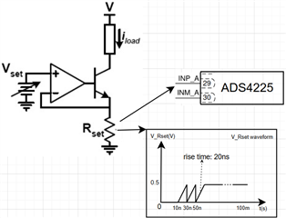

    More details for my question:
    I have the current sink circuit as below, I want to read the V_Rset value by using the ADS4225 ( parallel CMOS).
    The voltage range of V_Rset is 0V -0.5V as waveform below.
    Please advice the connection from Rset to ADC input.
    Thank you,
    Long Le Nguyen

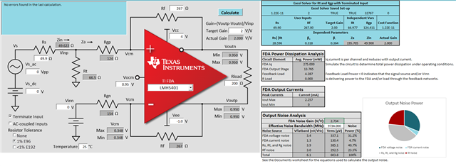

  • Hi Long,
    I would implement the circuit interface something like this. See below.
    Rob
    https://www.ti.com/tool/DIFFAMPGAINCALC
