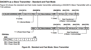

  • Hi Marcel,
    Can you please measure SDA and SCL on a scope and share a screenshot of the attempted read sequence so I can verify what you are actually doing and check for correctness?
    The procedure is shared in the datasheet with a visual representation and example sequence.
    Start bit, I2C address with R/W low, control byte address, repeated start, I2C address with R/W high, clock 2 or 3 bytes of data until DAC NAK, stop bit.

  • Hi Marcel,
    This looks correct, and the readback is correct if you had written 00 to the PD1 and PD2 bits. Perhaps the write did not take. Can you verify on your hardware that the output actually was set to 100k to GND and not high impedance?
    Can you try writing 0x40, 0x55, 0x55 and repeat your read sequence to see if we at least get the correct data back?
    Katlynne Jones

  • Hi Marcel,
    This is correct. This is why I am wondering if the write to the power down register actually worked.
    I would expect a readback value of 0xBF in stead of  0x3F
    Try to confirm the write worked by verifying that the DAC output is actually in 100k to GND and not high impedance.
    You can also try writing something to the data register and seeing if the read produces the correct data. My suggestion was to write 0x40, 0x55, 0x55 and repeat your read sequence.
    You should be able to copy past images directly into the text box, drag images directly into the text box, or use the insert > Image/video/file in the drop box options at the bottom of the text box.

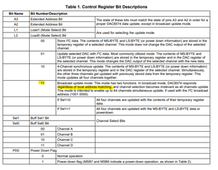

  • Hi Marcel,
    Paul's response is answering an issue related to writes where the first byte in a write is ACK'd, but the following are not due to the incorrect address bits. You verified that the write to the data register was successful by measuring the DAC output.
    Broadcast mode is used by setting the loa bits to 0b11 so the device ignores the local address (A3/A2):
    When in this sequence do you see the DAC output go to 1V? With command 0x50 you are loading the temporary register with the data so you should not see the DAC update on this command.
    In the read sequence, you are using command 0x51 to read the data register. At this time, you would not have loaded anything into the data register, so a readback of 0x3F, 0x0000 would be correct.

  • Hello Katlynne
    About the 0x50 I send, I get an value of 1 V as I would expect.
    As I understand for clarity for me once more
    bit
    76543210
    AALLXSSP
    3210X100
    01010000 bin gives me 0x50 hex
    Axx = 01 depends on Adres lines A3 and A2 in hardware
    Lxx = 01 ->
    Update selected DAC with I2C data. Most commonly utilized mode. The contents of MS-BYTE and
    LS-BYTE (or power down information) are stored in the temporary register and in the DAC register of
    the selected channel. This mode changes the DAC output of the selected channel with the new data
    X = don't care
    Sxx = 00 -> Channel Select Bits : Channel A selected
    P = PD0 = 0 -> Power Down Flag, 0 = Normal operation
    So then I think the DAC channel A is updated with data coming from MSB and LSB.
    So now I have 1V on the output
    Can I read this value back ? It doesn't work for me yet.
    What is the temporary register? Is it a write only register ? Is it being reset every time a write or read is done?

  • Hi Marcel,
    Two things to note.
    Even with just one device on the bus, a read command always reads back the data in the data registers (DRx) no matter what the load bits are. The temporary registers (TRx) are write only.
    When there is more than one device on the data bus with the same A2 and A3, the device is write only. Read with PD=0 always returns as 0x0000 and read with PD=1 always returns 0x3F00. It does look like there may be data on the bus coming from both controllers in this case when I look at the scope. So it's possible that your combo of pullup resistance and data is allowing some data bits to come through. I did confirm that with a single device, the DAC will respond to reads with other combinations of A2 and A3.
