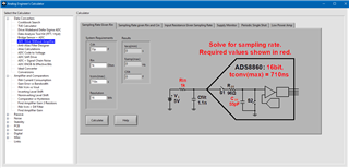

  • Hi WorkerBee,
    Could it be something from the Analog Engineer's Calculator? There are many options here, so I would recommend downloading it and taking a look to see if you find what you're looking for.
    Otherwise, it could be one of our Excel-based calculators. Do you have more information, such as what inputs the calculator takes, and what outputs it gives you?
    Joel

    Asking in a different way, if in the worst case, when i switch to a channel and take a sample with averaging of 32 samples.  is the worst case a 300ns 150ohm(typ) 15pF(typ) starting at 0V once, or 32 times?  (if S2 in your picture above is used between each sample then current draw would be much later

  • Hi WorkerBee,
    1. The TLA2518/2528 discharges its sampling capacitor to AVDD/2 after conversion is complete, so to answer your question, it resets 32 times, but to mid-scale, not fully down to 0V.
    It's important to keep in mind that to reach nominal resolution with an ADC, you need to allow for more acquisition time than ln(2^n)*R*C, where n is the resolution of the ADC in bits. ln(2^n) gives you the number of RC time constants you need to wait before the signal is fully settled. The result you get is in seconds.
    If you have a voltage divider, like in a thermistor circuit, the equivalent resistance is the two resistors in parallel. Then you would add any other resistors in series with the analog input. This means you can afford to sample more quickly if you have a smaller pull-up (or pull-down) resistor value, as long as the voltage drop across the thermistor is still within the input range of the ADC.
    2. In the case of thermistor circuits, it is very common to see them unbuffered. If it is a relatively static signal, it should be okay. If it is a dynamic signal, a higher frequency sine wave for example, you should consider adding an amplifier.
    3. I'll keep asking my colleagues for help in tracking down that Excel calculator. Seeing as you most likely can afford to sample slower and go without an amplifier to drive the ADC inputs, the capacitor on the ADC input contributes to the C value from number 1 above. The proper capacitor value allows you to filter higher frequency noise, while still allowing your signal to settle fully within the acquisition time.
