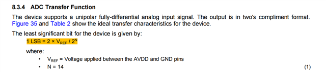

4.How should I process the data received via SPI? Should I directly use the formula mentioned in section 8.3.4 for the calculation?

    4. Yes, you need to extract the ADC conversion data from D13-D0, and you can then convert that to a voltage per the transfer function you noted.
