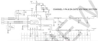

LMP92066 Configured as shown below.
During Power OFF output should go to 0V from -5V level.

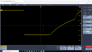

But we observed negative spike to a voltage level of -2.6V from -5V and then it is settling to 0V.
Attached the image below FYR.

Hi Upendra,
Is this the DAC output or the FETDRV output? The DAC output has some glitch during POR, but if FETDRV is connected to VSS you shouldn't see a glitch. Could you send a capture of the VSS signal during this time as well?
Erin
Hi Erin,
we observed the same spike of -2.5V level at FETDRV Output and VSS as well.
When we added series 20ohm resistor in VSS Pin before 10uF Capacitor, we observed negative spike reduced to -4V in VSS but it remains at -2.5V level at FETDRV output.

Hi Upendra,
Could you potentially send us a scope screenshot showing VSS, DRVEN, FETDRV, and VDD during shutdown? Additionally, could you send a screenshot of device schematic?
