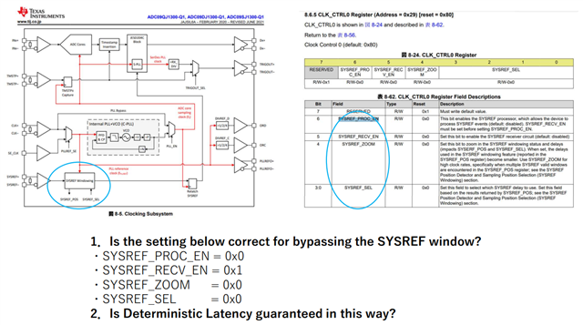

Hello, experts.
On our board, the SYSREF window is not very effective and there is a high frequency of Invalid/NotInTable/Disparity errors of TI-JESD204C-IP.
I would like to use the SYSREF signal itself, but I am considering not using the SYSREF window.
Please tell me two things.
1. Is the setting below correct for bypassing the SYSREF window?
  • SYSREF_PROC_EN=0x0
  • SYSREF_RECV_EN=0x1
  • SYSREF_ZOOM=0x0
  • SYSREF_SEL=0x0
2. Is Deterministic Latency guaranteed in this way?
Thank you.

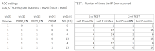

  • Hello Eric,
    Sorry for the late reply.
    I will share a check of the number of occurrences of IP Error on our board.
    Based on these results, I think the only good configuration is not to use sysref windowing.
    Each ADC settings were tested twice.
    In one test, the number of IP errors was checked immediately after power input and two minutes later. (The test temperature is always around 25°C.)
    Thank you.
