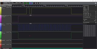

  • Hi. Below are the latest logic analyzer captures for SPI clock set to idle low, inactive outside word, data on falling edge. I get nothing on the DOUT line except that with these settings it follows the NOT CS exactly. The first image is a wide view showing the DOUT/DRDY following CS and the second is a closer view showing clock and MOSI from SPI bus to 1261 for the reset command 0x06, 0xFF, 0xFF, 0xFF. For some reason I can no longer get the logic analyzer to decode using these settings. I also discovered that the SPI Bus must be disabled between activity and enabled before transmit and also the SPI clock must be set to innactive outside word otherwise the logic analyzer will capture nothing and everything is flat. The DOUT/DRDY looks like it is stuck in DRDY mode and refusing to go to DOUT mode to transmit data, though of course this is just a wild guess. My HW engineer has not yet pinned out the dedicated DRDY line but we are doing that now so we can check for the 50 Hz you mentioned. Many thanks.
  • Hi Everett Everett,
    Can you clarify how your signals are labeled in the images you sent? Each signal has a written label, and then underneath has an associated label for the SPI analyzer. For example, the first (yellow) signal says "SDI" and "SCS". Since these are in conflict, which is correct? I cannot tell from the signals themselves, other than the blue signal appears to be SCLK
    If the green signal is CS, why are you sending SCLKs and info on DIN when CS is high? The device will not respond to any commands while CS is high. So can you clarify what you are showing me?
    -Bryan

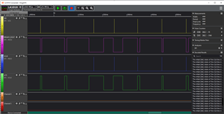

  • You are correct, I noticed the same thing myself this morning, somehow our logic analyzer channels got changed. This should be fixed now in the following diagram. In the same order the channels are positioned in the diagram:
    Channel 1 Blue is SCLK,
    Channel 3 Yellow is SDI MOSI (Master SPI Bus out Slave 1261 In).
    Channel 0 Purple is DOUT/DRDY (MISO),
    Channel 2 Green is NOT-CS,
    I have the Xilinx SPI bus master set to clock quiescent low, clock not active outside word. In this run I ran the bus in manual mode. In this run I also cycle through all three slaves on the bus sending the reset command to the 1261 using a different slave in an effort to see if I could get chip select to move but nCS is not moving at all. Our HW engineer insists CS is hooked up correctly but it is behaving like the Xilinx SPI bus is not driving it regardless of the register setting for the selected slave. Also as you can see the SPI bus is only driving the clock during transmit which means there is no clock available to the 1261 to respond for the second byte. I'm not sure how to fix this.
    Also, as you suggested, we hooked up a scope to the dedicated 1261 DRDY pin and only set the START pin and did nothing else and there is no periodic signal on the 1261 dedicated DRDY.
    EDIT: I also reran the test setting clock to active outside word and the bus in automatic transmit mode and the resulting graph is exactly the same, no movement on CS or DOUT.
    I think the first priority is to figure out why the 1261 is not responding to START with DRDY and why the Xilinx SPI bus is not moving CS, though I'm not sure yet how to proceed. Below is the latest plot with the channels set up correctly.
    Your SCLK is still triggering on the wrong edge in the capture (should be on the falling edge). If that is the case for just the analyzer, then that shouldn't affect the communication, just your captures will be wrong. If the controller is capturing data on the wrong edge however, then the communication won't work.
    Can you send us a schematic?
    Can you send us pictures of your setup i.e. how is it all connected together?
    Do you have an EVM you could try? This can act as a baseline for your board, so you know what the communication should look like and because the EVM analog / digital circuitry has been tested
    -Bryan

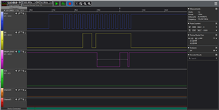

  • Bryan,
    Hi. We fixed our board and fixed the CS pin. After doing this and carefully reviewing my software I run the Xilinx SPI bus in Manual Slave Select and Auto Transmit and I get the following graph. This is a huge advancement over before because the 1261 is obviously responding in some way. However in response to the reset command TX 0x06, 0xFF, the 1261 drives the DOUT with 0xC6, 0xFF. The response has two high order bits added changing the 0x06 to 0xC6. My software confirms that it is reading the 0xC6 from the FIFO which matches the logic analyzer decode in the diagram below.
    Also the Xilinx SPI bus is only driving the clock during transmit and I have not yet figured out how to keep the bus clock going for the full 1261 response, but this I suppose would be a question for Xilinx. Right now I am cheating by transmitting extra 0xFF to keep the bus clock running to the 1261. Chip select is changing but it is outside the width of this diagram.
    Your logic analyzer is still triggering on the wrong edge (needs to be on the falling clock edge). It also looks like your controller is launching on the wrong edge, because DIN is stable on the rising clock edge (see image below). However, you want DIN to be stable during the falling clock edge because this is when the device is latching that value. If DIN is transitioning on the falling clock edge, the device might interpret the data incorrectly.
    Please correct these settings in the controller and hopefully the device will respond correctly
    Also, the RESET command only requires that you send two bytes, and you will receive two bytes in the same frame. It is not clear to me why you are sending 4x bytes in the capture above when you are trying to send the RESET command
    -Bryan

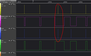

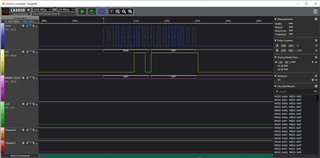

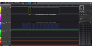

  • I am still unable to get consistent results from the 1261. Basically what is happening repeatedly is that I get hundreds of failed reset commands and one good one, then at that point if I assume the 1261 is running and try other commands I might get one more good one and then the rest fail.
    From the diagrams below you can see that it responds to what looks like two or three commands and then DOUT goes low and does not move after that.
    I have captured five diagrams from the logic analyizer to show this entire series of events. In this order, 1 - A scaled out view over 9 seconds at boot showing action on the DOUT and then silence, 2 - A slightly magnified view of the good portion between 2.100 and 2.103 seconds. 3 - A clock level view at approximately zero seconds showing the first successful response to the reset command, 4 - A clock level view of the second to last success around 2.101 which is a blow up of the second image first spike, 5 - A clock level view of the last successful reception before DOUT goes quiet at 2.101695.
    Keep in mind this all occurs after hundreds of failures to respond at all to the rest 0x06 command. My experiment to just boot the bus and send reset commands until the 1261 responds and then read the registers was based on the assumption that after responding to reset the 1261 would be good but obviously that is not the case.
    Since I found the right bus clock settings mentioned above and baud rate to get one good reset response on DOUT I am no longer touching those parameters. However, I have experimented extensively with the direct START and RESET pins as well as enabling the SPI bus once and leaving it on or enabling it and disabling it around each command, but that was not successful.
    At this point I have essentially experimented with every possible parameter on the Xilinx SPI bus available to the software, or at least the obvious ones, and I am looking for a more analytical approach to getting the 1261 to respond consistently.
    Many thanks for your help so far,
    Everett
    Diagrams below mentioned above:
    Your SCLK must idle low at all times. You can see in the images below that SCLK is idling high for 100s of microseconds, can you fix this? Basically you should only be toggling SCLK when you need to send SCLKs, otherwise that signal should remain low
    Do you have one of our EVMs that you can use with our board? You can use the controller portion of our EVM to hook into your board so you can communicate with the ADC, just to make sure that your ADC portion is working correctly (it sounds like you are having a lot of issues with your controller)
    -Bryan
