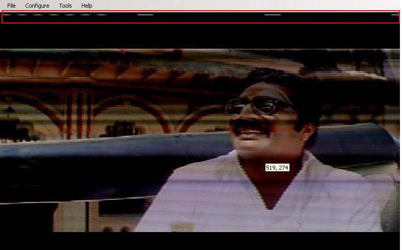

Hello Sir,
We are using TVP5150AM1 video decoder.When DVD video is playing we are getting the some unwanted dotted lines at the top of video.We need to cropp these unwanted lines at the top of the video screen.Please see below for the image which is marked in red colour.From the data sheet of "TVP5150AM1" we came to know that if we use AVID registers(11h, 12h) register setting then we can able to remove these unwanted data.But from the data sheet we are not able to set the register values.Requesting you to please provide some infromation how to set those registers.If you know any solution to this problem please share with us.

  • Satish,
    The dashed line is closed caption VBI data that is carried on line 21.  Do you have a way to crop this line in the processor or vertically shift the display so it is not visible.  This line is typically cropped in the back-end and not by the TVP, since some processors need to process the data that is own this line.
    You are using embedded syncs, right?   Registers 11h-12h control horizontal horizontal position of AVID signal and the horizontal position of the EAV/SAV embedded sync codes. VBLNK settings control the vertical postion and duration of the AVID signal but do not alter the position of the embedded sync V-bit.  The embedded sync vertical position cannot be changed by a direct I2C resgister and is more difficult to control.  It is best to control this in the back-end processor.
  • Hello Larry Taylor,
    Thanks alot for the replay.We will try to cropp that unwanted dotten lines from back-end process.But we need some information how to set the VBLK(18h, 19h) registers.If you have any information how to set these regsiter values please share it with us.From the data sheet not getting complete inforamtion clearly.We tried setting those (18h-19h) registers , but we are geeting some extra lines on the screen.

  • The VBLK Start/Stop registers affect the VBLK interval of the AVID output signal (pin26).  Increasing VBLK Stop (REG19h) by 1 should move the first line from the active portion of the AVID output signal.  For this to be effective at removing the line, the processor must use the AVID output signal to qualify active video.  The video lines to do not automatically get forced to black level during the VBLK interval.
