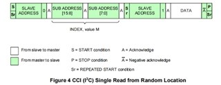

Does DAC6571 support CCI(Camera Control Interface)protocol?
An ack is returned for the Write command, but the Read command in the latter half of the diagram results in a Nack.

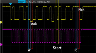

    I am not familiar with CCI but it looks like most CCI devices should be compatible with I2C devices. Can you capture the CCI sequence on a scope and send a screenshot so I can review the timings? If you just send a write command, does the DAC output update with the correct output voltage?

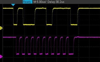

  • Thank you for your quick reply.
    I am attaching a captured waveform.
    Slave Address "1001101"+Wr --> Ack
    Next Byte..
    1) Do I need 2 bytes of Ctrl/MS and LS for the following data? Only 1 byte is sent in the captured waveform. (Currently requesting correction)
    2) MSB 2 bits of Ctrl/BS are "01". Will this be a problem? (I understand that it is specified as "00")
    And the Read command after the restart is Nack.
    Slave Address ”1001101”+Rd --> Nack
  • Next info has arrived.
    The first time I sent a read command, it returned a NACK.
  • Hi Takanori-san,
    The scope plots look correct. I took a look at the parent device for this family (DAC7571) and that device datasheet mentions that the R/W bit should always be set to 0 indicating that the device does not support I2C reads. The DAC6571 has the same digital logic, so it will also not support the read commands.
