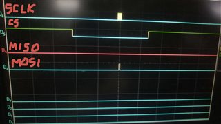

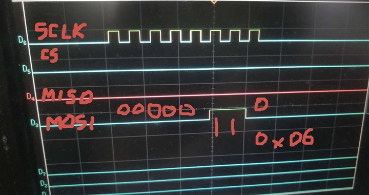

Logic Analyzer
RESET:

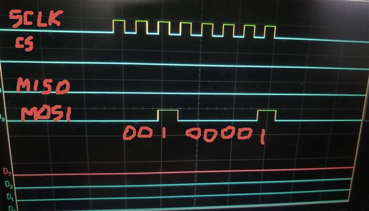

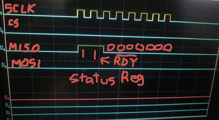

RREG:
then I send 0x00
and 0x00 again to read the MISO:

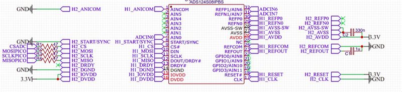

Electric diagram:
