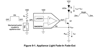

Just want to use below example,
1) connect GPI to MCU IO, pin, send 1KHz PWM
2) setup proper Rset, so can I generate constant current source for LED?
I mean, 1 KHz, 10mA low , 20mA high PWM
Part Number: DAC53701
Hi Liping,
The device will not send a PWM with this setup. This is meant for a constant current. You can set the DAC output to 1V or 2V with a 100ohm RSET to get 10mA and 20mA.
