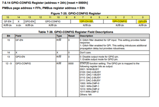

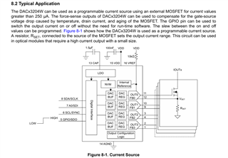

Target application:  to achieve PWM current source,   5mA/0.5ms,  20mA/0.5ms, 1KHz PWM.
schematic:  VDD=3.3V,  MOSFET gsth = 0.9V, Rset = 51ohm, use internal reference.
software: spi setting output 5mA, and after 0.5ms refresh spi setting output 20mA......
Question:
1) does it works or not from above?
2) what's the difference between DAC53204 and DAC53204W?  Can I use DAC53204?
