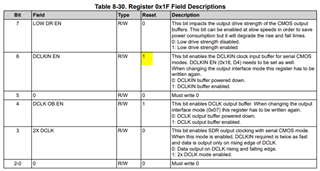

  • Hi Luke,
    I work on Tom's team. I tried the settings you posted but it made our ADC3660 device inactive, and it no longer captures data. After further investigation, we found there were some registers that were missing from your list such as 0x18 and 0x1F. These are very important registers for our application. Thank you for your suggestion. We are looking closer at our settings of the ADC3660 in comparison to other device settings to ensure they align with our design.
    You are correct that these registers are not written to in the configuration I provided above. This is because the DCLKIN Buffer is enabled by default, meaning 0x18, bit 4 and 0x1F bit 6 are set to 1 by default. In 1W, Real Decimation mode, the output data is serialized, and the DCLKIN Buffer must be enabled.
    If you have any other details about your application that is relevant to the config, let me know and I can help you get a working config. If needed, let me know and we can move this discussion to an email.
