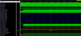

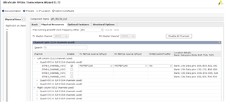

    thanks for your reply. On Vivado I can simulate the original zcu102_8b10b reference design with 8 lanes and 64 bits per lane. However, when I configure it down to a single lane and 32 bits to reflect the characteristics of the ADC14X250M something around the transceivers seems to be odd in simulation. I've used the same force commands to stimulate both the 8-channel and the single-channel simulation.
    This is my transceiver configuration, using only one Quad and one channel:
    And this is what 1ch simulation looks like:
    Mariano
  • Hi Ameet,
    my issue is more or less solved now. The cause seemed to be changing the Tx/Rx lane widths to 32 bits down from 64 bits. I changed them in both the transceiver config as well as in the verilog header file.
    Everything works fine if I keep the lane width to 64-bits. I should be able to make do with this, but I would like to understand why, given that the IP docs state that 32-bit widths are supported.
