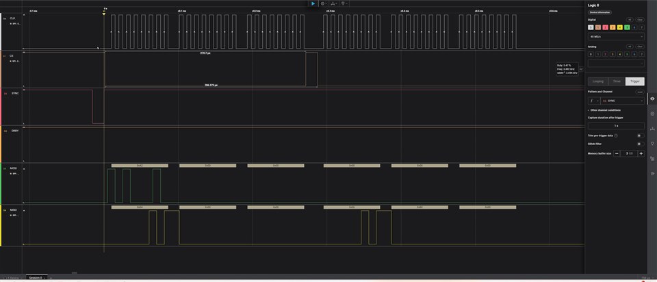

Please see attached scope plots.  we can get the ADS131M02 to work but not he ADS131M08.
ADS131M08.    DOES NOT WORK
28000 reads analog=0.000 0.000 0.000 0.000 0.000 0.000 volts
first byte returned=28000H=00101000000000000000    is this status register?   What is it saying?
ADS131M02 WORKS
first byte=28180    read analog=0.753   0.753 which are correct voltages
first byte returned=28180H= 00101000000110000000    is this status register?   What is it saying?  Is this reason DRDY stays high?
thanks
  • Hi Peter,
    Are you able to read any register from ADS131M08? Can you provide a clear timing plot like the following timing for data reading or register reading?  In order to read conversion data from ADS131M08, you can send the SPI clocks of 10 words and each word has 24 SCLK clocks.
    Read the GAIN register (0x4 address) with RREG command:
    The answers to your questions:  Yes, the first word is STATUS word, you can check the STATUS Register for the details in the register map in the ADS131M08 datasheet.
    By default, you should be able to see toggling on the /DRDY signal after ADS131M08 is powered up. If you can not see it, please provide your schematic for review.

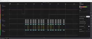

  • We used a Logic analyzer to take these traces.  DRDY is still stuck high. Top trace glitch shows DRDY is connected.  Middle trace reads 6 channels but all are 0.  Bottom trace reads STATUS.  We ignore DRDY since always high, even if we wait long time.  Is ADS SCHEMATIC CORRECT bottom left?  DO WE NEED TO PRESET REGISTERS?
  • Hi peter,
    You did not answer my question, where is your input clock to the ADC (pin 23 - XTAL1/CLKIN)? Your schematic does not show it.
    In your first timing, the /SYNC from your microcontroller was always low, this signal forced the ADC to Reset mode.
    In your second timing, the ADC did not convert as the /SRDY is always high, the clock may be missed.
    In your third timing, your tried to read a register but your SPI configuration on your microcontroller was wrong, your were sending commands to the ADC at the rising edge of SCLK, the right edge is falling edge, the SPI setting should be CPOL = 0 and CPHA = 1.
    BR,
    Dale

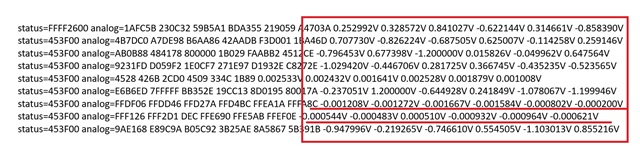

    ============CORRECTED STATUS INTERPRETATION BELOW=================================================
    status=453F00 analog=7FFFFF 7FFFFF 7B8DD5 68B608 4AEE8B 7FFFFF =synchronization occurred=Reset occured=Ch5 data ok=Ch4 data ok=Ch3 data ok=Ch2 data ok=Ch1 data ok=Ch0 data ok
    status=453F00 analog=5D441A 79595F 415230 FF26AA 7FFFFF F15A07 =synchronization occurred=Reset occured=Ch5 data ok=Ch4 data ok=Ch3 data ok=Ch2 data ok=Ch1 data ok=Ch0 data ok
    status=453F00 analog=63401 6698B 66350 65C12 64C05 642AA =synchronization occurred=Reset occured=Ch5 data ok=Ch4 data ok=Ch3 data ok=Ch2 data ok=Ch1 data ok=Ch0 data ok
    status=453F00 analog=2DAB35 7FFFFF 7FFFFF 7FFFFF BCA42E 15D7D5 =synchronization occurred=Reset occured=Ch5 data ok=Ch4 data ok=Ch3 data ok=Ch2 data ok=Ch1 data ok=Ch0 data ok
    Status bits indicate that Reset or Synchronization may be cause.  Is uC running too slowly?
    I have noticed you just added an external clock to the XTAL1/CLKIN pin in your latest schematic. Your schematic looks good now, I did not see the REFIN pin of ADS131M06-Q1 in your schematic, I guess it is floating on your real circuit board.
    You are sending more SCLKs than the SCLKs that is needed for the ADC in one frame. ADS131M06-Q1 requires the SPI clocks for one STATUS word + 6 channel data + one word for CRC = 8 words, you are sending 9 words (each word has 24 SCLKs), so the data on DOUT in the last word (0x053F) in your timing is the right data of the STATUS register, the 3F in 0x053F indicates that the data on all input channels are ready (0x0500 is the default register data).
    You can start the test with internal test signals (shorted input or a DC test signal) by setting MUX[1:0] to a proper value in the CHx_CFG register.
    By default, internal 1.2V Vref is enabled and the gain is 1, so the code for a positive .3V SE input voltage is
    • 1LSB = (2*1.2/Gain)/2^24 = 0.1430511uV
    • 0.3V/0.143uV=2097152 in decimal = 0x200000 in Hexadecimal format.

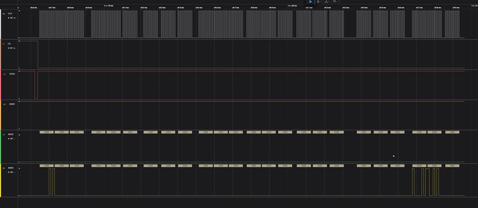

  • Dale, Attached is a re-run along with the setup where .38V is on each input.  We will re-run the 2 channel on Monday.  CPHA = 1  - CPOL = 0 confirmed and checked by ChatGPT.  Thanks for your patience, Peter
  • Session _rename_to_SAL_extension.pdf  your server would not let sal upload so please change extension to SAL for the Salaea scan. thanks
  • Good news is that we used an ADC Click ADS131M02 and it works perfectly and outputs the exact voltage we put into the channels.  Now we will go back to our circuit that uses the ADS131M06.
  • Hi peter,
    Thanks for update. Why did you always send 5 words (24-bit) to ADS131M02 in one frame?
    -Dale

    status=453F00 analog=FFEFD8 FFD622 FFD59D FFE119 FFE839 FFF587 -0.00V -0.00V -0.00V -0.00V -0.00V -0.00V
    status=453F00 analog=FFEF7E FFD447 FFD8D0 FFE584 FFDC96 30D -0.00V -0.00V -0.00V -0.00V -0.00V 0.00V
    status=453F00 analog=FFCB4E FFE059 FFC5E0 FFDB02 FFBE0C FFC70E -0.00V -0.00V -0.00V -0.00V -0.00V -0.00V
    status=453F00 analog=4A5B 4D83 365D 3242 4194 447A 0.00V 0.00V 0.00V 0.00V 0.00V 0.00V
    status=453F00 analog=47400E CE96C 69C9DC 5CF284 E280EB 509611 0.67V 0.12V 0.99V 0.87V -0.28V 0.76V
    status=453F00 analog=FFF384 FFF735 FFFCE5 105E FFF175 1E47 -0.00V -0.00V -0.00V 0.00V -0.00V 0.00V
    status=453F00 analog=278B 1402 25C8 1CCD 2571 1CDB 0.00V 0.00V 0.00V 0.00V 0.00V 0.00V
    status=453F00 analog=8A998F 86E292 CE4C66 519F0C 8F76F5 28EA97 -1.10V -1.14V -0.47V 0.77V -1.06V 0.38V
    status=453F00 analog=2982 206E C15 2646 1AA5 FFFECC 0.00V 0.00V 0.00V 0.00V 0.00V -0.00V
    ot is correct.  All inputs are grounded for tests but this outputs random voltages.  All pins connected.  We have changed ADS131M06.  I and still same results.  Is 12MHz clock a problem?  What can cause random voltages? thanks
    Is 12MHz you SCLK frequency or mater clock to CLKIN? I would suggest to do an internal short by setting MUX[1:0]=01b and test again.
    -Dale

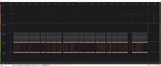

  • We put on a 16Mhz clock but it did not fix the problem.  All inputs are grounded.  Some readings are good at uV.  It would appear that the data is shifted to cause an error.
    BAD
    GOOD
  • BAD READUBGS HERE
    There is no obvious reason for the different readings.

  • status=453F00 analog=27A8 419 309E 1AD0 330C 1522 0.001452V 0.000150V 0.001780V 0.000982V 0.001869V 0.000774V =synchronization occurred=Reset occured=Ch5 data ok=Ch4 data ok=Ch3 data ok=Ch2 data ok=Ch1 data ok=Ch0 data ok
    status=453F00 analog=29E4 3828 184D 3A7D 168F 33BE 0.001534V 0.002057V 0.000890V 0.002142V 0.000826V 0.001895V =synchronization occurred=Reset occured=Ch5 data ok=Ch4 data ok=Ch3 data ok=Ch2 data ok=Ch1 data ok=Ch0 data ok
    status=453F00 analog=3E993 1EA7A 7FFFFF BF79EB 13184D 8C6C56 0.036679V 0.017962V 1.200000V -0.604910V 0.179015V -1.083533V =synchronization occurred=Reset occured=Ch5 data ok=Ch4 data ok=Ch3 data ok=Ch2 data ok=Ch1 data ok=Ch0 data ok
    status=453F00 analog=31EC 2954 11AE 3873 30F2 1365 0.001828V 0.001513V 0.000647V 0.002067V 0.001792V 0.000710V =synchronization occurred=Reset occured=Ch5 data ok=Ch4 data ok=Ch3 data ok=Ch2 data ok=Ch1 data ok=Ch0 data ok
    status=453F00 analog=3894 28DD 3216 1E7B 28FF 3EC9 0.002072V 0.001496V 0.001834V 0.001116V 0.001501V 0.002299V =synchronization occurred=Reset occured=Ch5 data ok=Ch4 data ok=Ch3 data ok=Ch2 data ok=Ch1 data ok=Ch0 data ok
    status=453F00 analog=FFE83F B31 10C FFE461 FFE18D FFE39A -0.000870V 0.000410V 0.000038V -0.001012V -0.001115V -0.001040V =synchronization occurred=Reset occured=Ch5 data ok=Ch4 data ok=Ch3 data ok=Ch2 data ok=Ch1 data ok=Ch0 data ok
    status=453F00 analog=17F5 FFF606 FFFF9A FFF721 26C FFF1D4 0.000877V -0.000365V -0.000015V -0.000325V 0.000089V -0.000519V =synchronization occurred=Reset occured=Ch5 data ok=Ch4 data ok=Ch3 data ok=Ch2 data ok=Ch1 data ok=Ch0 data ok
    status=453F00 analog=D1555A 800000 43F3D2 40EC60 660501 7FFFFF -0.437499V -1.200000V 0.637054V 0.608656V 0.956434V 1.200000V =synchronization occurred=Reset occured=Ch5 data ok=Ch4 data ok=Ch3 data ok=Ch2 data ok=Ch1 data ok=Ch0 data ok
    status=453F00 analog=8979C2 7FFFFF A062D7 800000 74D03 471E26 -1.111166V 1.200000V -0.896381V -1.200000V 0.068445V 0.666729V =synchronization occurred=Reset occured=Ch5 data ok=Ch4 data ok=Ch3 data ok=Ch2 data ok=Ch1 data ok=Ch0 data ok
    status=453F00 analog=45E2DE BCFB98 702EC1 181B83 FAF57C 7FFFFF 0.655183V -0.628287V 1.051712V 0.226008V -0.047260V 1.200000V =synchronization occurred=Reset occured=Ch5 data ok=Ch4 data ok=Ch3 data ok=Ch2 data ok=Ch1 data ok=Ch0 data ok
    status=453F00 analog=207A 2BA7 1CD0 2816 331F 35ED 0.001189V 0.001599V 0.001055V 0.001468V 0.001872V 0.001975V =synchronization occurred=Reset occured=Ch5 data ok=Ch4 data ok=Ch3 data ok=Ch2 data ok=Ch1 data ok=Ch0 data ok
    status=453F00 analog=3AB0 365E 4636 24A1 3FE4 2C37 0.002149V 0.001991V 0.002571V 0.001341V 0.002340V 0.001619V =synchronization occurred=Reset occured=Ch5 data ok=Ch4 data ok=Ch3 data ok=Ch2 data ok=Ch1 data ok=Ch0 data ok
    status=453F00 analog=FFE95F 75E FFF2E6 882 FFF153 FFE3C2 -0.000829V 0.000270V -0.000480V 0.000312V -0.000537V -0.001034V =synchronization occurred=Reset occured=Ch5 data ok=Ch4 data ok=Ch3 data ok=Ch2 data ok=Ch1 data ok=Ch0 data ok
    status=453F00 analog=15E929 890581 4CB05C 7FFFFF 800000 7FFFFF 0.205414V -1.115424V 0.718959V 1.200000V -1.200000V 1.200000V =synchronization occurred=Reset occured=Ch5 data ok=Ch4 data ok=Ch3 data ok=Ch2 data ok=Ch1 data ok=Ch0 data ok
    status=453F00 analog=1824 89E 148F FFFC6F 12C3 21 0.000884V 0.000316V 0.000753V -0.000131V 0.000687V 0.000005V =synchronization occurred=Reset occured=Ch5 data ok=Ch4 data ok=Ch3 data ok=Ch2 data ok=Ch1 data ok=Ch0 data ok
    status=453F00 analog=4BF66A B132BD A4ABA6 EE614C 8CACA 7FFFFF 0.712149V -0.738767V -0.856214V -0.165187V 0.082426V 1.200000V =synchronization occurred=Reset occured=Ch5 data ok=Ch4 data ok=Ch3 data ok=Ch2 data ok=Ch1 data ok=Ch0 data ok
    status=453F00 analog=493425 800000 44E01D 74C566 A80BC4 11882B 0.686285V -1.200000V 0.645707V 1.094729V -0.824569V 0.164362V =synchronization occurred=Reset occured=Ch5 data ok=Ch4 data ok=Ch3 data ok=Ch2 data ok=Ch1 data ok=Ch0 data ok
    status=453F00 analog=4420 3B65 3C15 2920 505F 38CA 0.002495V 0.002175V 0.002200V 0.001506V 0.002943V 0.002080V =synchronization occurred=Reset occured=Ch5 data ok=Ch4 data ok=Ch3 data ok=Ch2 data ok=Ch1 data ok=Ch0 data ok

    Here are the latest plots using an 8MHz clock.   All inputs are grounded.  Some readings are good and others are wrong.  This web page did not allow me to upload the capture file.  thanks
  • This is a capture file for Saleae.  thanks, peter
  • This is a capture with some perfect and some not perfect data.  they look the same so no idea why it sometimes works.  8Mhz clock looks clean. thanks
  • Hi peter mccormick,
    Thanks for sending the .sal file, that helped.
    In the most recent one I am seeing what looks like all good data, assuming you have the inputs shorted. Either way, both data sets look the same even though the file is named "CaptureGoodandBadReadings". See image below where I converted hex to codes, so these indicate a very small negative voltage being measured
    Can you help explain this discrepancy?
    You are also not reading the complete frame before the next DRDY transition, see the second image below. Can you increase the SCLK speed from 400kHz to at least 1MHz?

  • I changed the clock to about 1Mhz.  The MSP4304619 appears to be able to keep up with 1MHz.  Attached are captures which do not appear to be as good.captureMay29_131.saldigitalMay29_133.csv
  • Yes, I noticed that DRDY changed before it got to the CRC in frame 8
    I have also seen DRDY change before CRC in some examples you sent for the ADS131M08 or 10 frames total
    I assume it is: Status-6data-crc or 8 frames total

    captureMay29_7pm.sal
    Can you try collecting 4 conversion periods after the SYNC pulse that you generate, instead of 1x?
    In other words, send the SYNC command, then wait for DRDY to go low, clock out data1, wait for DRDY to go low again, clock out data2, etc., until you get 4 complete data frames. Do this with the default ADC settings, and make sure the inputs to the ADC are shorted to ground. This way you are basically reading the ADC noise on each channel
    Alternatively, you can try waiting until the 4th DRDY high to low pulse to clock out data. So, toggle SYNC, then wait for 4 DRDY high to low transitions, then send your SCLKs to collect a single data frame.
    Let me know if the data you get is more consistent. Please take multiple data sets so we can be sure
    -Bryan
