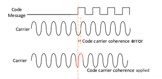

My customer wants to apply the following code carrier coherence to DAC39RF10-SP.
Q1. If you have any reference materials for implementing this feature in DAC39RF10-SP, please share it.
Q2. They thought that they could implement this feature using the JESD204C LSB Synchronization of the DAC39RF10-SP. Is it correct?
Thank you.

    The customer would like more clarity from TI regarding the implementation of code carrier coherence feature for the DAC39RF10-SP.
    Q1. The customer thinks they can implement this feature with JESD204C LSB synchronization, is this correct?
    Q2. If so, could you please provide a detailed explanation of the example control method and the expected output waveform?
