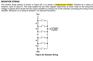

DAC8571: DAC8571IDGKR Output 2V/V Gain
Part Number: DAC8571
Does tying the VSENSE to VOUT pin cause the output to be unity gain or amplified by 2V/V? Pages 11 and 12 of the datasheet seem to contradict themselves on what will happen. My DAC output needs to be 0-2.5V as per my Vref, but I am not sure if it will come out as 0-2.5V or 0-5V.
