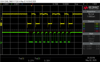

    I'm currently using a RedPitaya that provides two 3.3V I2C signals. I tried your suggestion by connecting J16, J17, and J1. Additionally, I set jumpers J5 to 1&2 and J6 to 3&4, so that VIO is tied to VDD, both at 3.3V. All VIO lines and my I2C signals are therefore operating at 3.3V.
    The way I'm testing the I2C communication is with the following approach: I run a try/except loop to scan all possible addresses and print out any that do not raise an error.
    Attached are pictures of my code and the oscilloscope results.
    Python I2C generation code
    Oscilloscope screen
    Thanks for your help,
    Jean
  • Hi Jean,
    So your program goes through addresses 0 to 128? It should definitely catch something then. I don't see anything wrong with your sequence either, which is unsurprising since you said it works for other devices. Perhaps you can try lowering the I2C speed? 1MHz is the upper end of the device's range - so maybe you'll have better results with a lower speed.
