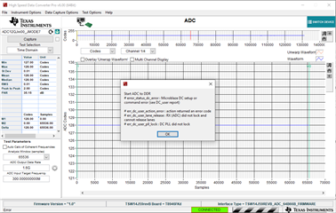

After configuring the ADC Board using the corresponding EVM GUI, and launching the HSDC Pro software, we can load the FPGA firmware but we don't have supported JMODEs (JMODE0) corresponding to the recommended ones in the documentation. Trying to use one of the others available options, after changing the ADC configuration, resulted on the following error message.

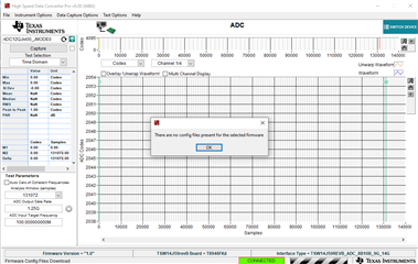

The documentation mentions INI files that need to be downloaded and added to the HSDC Pro instal folder, but the files that we could find on the EVM page correspond to the TSW14J57EVM, which uses a different FPGA.
Are those files available anywhere? Does anyone know another workaround?

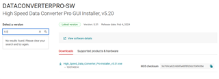

    At the HSDCPro site on TI.com, you can download both v5.2 and v6.0
    Its mis-labeled, I have requested this to be fixed, so please try downloading both links there at the site.
    Either there is some region lock bloking me from acessing, or we are not acessing the same link. Here ia screen capture of the webpage: https://www.ti.com/tool/download/DATACONVERTERPRO-SW
    As you can see, there is no 6.0 version available. Have you tried running an older software version to see if this is an issue, as I asked before?

    When talking about .ini files, I imagine you talk about these ones.
    As you can see, the files downloaded directly from the ADC12QJ1600EVM website are ones from 2019/2020, and are clearly labeled to the TSW14J57RevE, which is not our card and uses a different FPGA altogether.
    All our attempts come from selecting the device in the dropdown menu on the High Speed Data Converter PRO capture window, and the errors are already listed in my previous posts.
    We've noticed that for the TSW14H59 RevB board that we have the software pulls the JESD configuration parameters from a excel file named 14J59revB_Mode_Details.csv located in the folders "14J59revB Details\Device Files". On this file the only available configurations that exist for the ADC12QJ1600 are the ones shown in the picture below.
    We have also tried to create a new entry for this table that corresponds to the configuration parameters needed for JMODE0 that can be found on the ADC12QJ1600 datasheet, but when doing this, the software throws a misconfiguration parameters when trying to read the new input that we've created.

  • I double check all links in the page and they are possible fixed in a different way. Now both links are tagged as 5.20 and both leads to download page of 5.31 file. There is no link to v6 on page.
    If I look for other versions, only v5.3 and v1.0 are available to download. I did not succeed in any search for version 6 too.
    Do you matter to point to v6.0 version ? As I am afraid fixing it on page can take to long is it possible to share a personal/private repo link with this version with us, please?
    Thanks a lot for all support.
    Renato
  • Fabio, Renato, I do apologize, I do not see HSDCPro V6.0 on the web either. Please download it here. See below. You have 24hours before the link expires.

    However, when using the internal PLL, we're still facing a similar issue as before. Here is the message that appears.
    We've confirm the PLL does get locked, not only via software. We also made sure that the input reference clock (50 MHz) is correct by measuring it on resistor R231. Here is a screenshot showing the PLL locked screen.
    We think this may be a problem with some configuration on the capture card side, since the ADC seems to be fine. Could you provide any additional insight for us?

    For any 8b/10b modes, like JMODE0, the capture card gives an error like the ones below.
    While using a 64b/66b JMODE, this does not happen. For our application, we can use these modes work, so going forward I think we should look at them. We were only using JMODE0 as it is the one especified in the User guide, just that.

  • Hi Fabio,
    For JM6 and JM7, we can support JM7 or use JM0 or JM8 in substitution to JM6. The performance is the same. For JM6 we would need to develop FW for the FPGA as the data is packaged differently.
    See attached JM7 ini file, this goes in the HSDCPro root directory where all the other ini files are located.
    C:\Program Files (x86)\Texas Instruments\High Speed Data Converter Pro\14J58 Details\ADC files
    We also found an issue with the ADC GUI.
    Start on the EVM tab of the GUI as you normally do, after you program the device, go to the ADC PLL tab, click on the "check PLL status" the PLL Locked box, should turn green. But it is red.
    In order to get the internal PLL to lock, do the following, go to the Low Level View and click on reg address 0x53. In the write data box, it says x83. Which is correct, but for some reason this is not being programmed. So delete the x83 and retype x83 in the write data box and hit enter. Then click read data box. It should show x83.
    Now go back and check the PLL status and the PLL Locked box should turn green. In the ADC PLL tab
    Next, go to the TRIG OUT tab and find the RX_DIV, cycle the DIV setting so it sets properly. You can also verify this in this in the low level tab once you cycle this.
    Now go to HSDCPro and you should get a clean capture.
    Please try this and see if you can get it working on your end.
