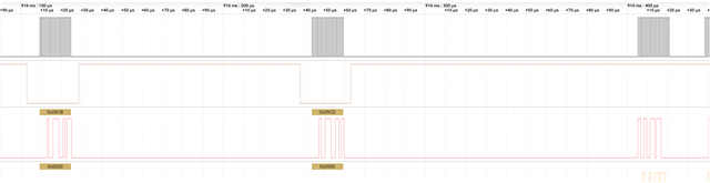

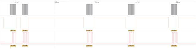

  • Through to the 16th packet:
    Then switch to programming an LT DAC.

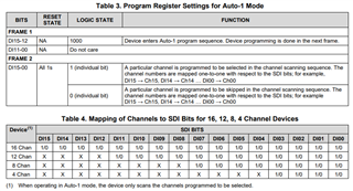

    Yes, exactly the same sequence.  I'm fairly confused because on page 36:
    With page 37 indicating:
    I'm using:
          xfer(0x2000);   //  Auto-1, Logic State
    Presuming Table 2 is correct.  No progress with cmd == 0x8000

  • Hi Danny,
    It looks like you're using a Saleae, so could I ask you to export the logic capture as a file, zip it, and attach it here? I can take a closer look in the Logic program, and verify if any timing might be off. At a glance, this seems to be correct.
    Joel
  • Hi Danny,
    So it looks like you are not entering the auto-1 programming mode (0x8xxx). The reset state is supposed to have all channels enabled, so maybe at some point you sent the 0x8000 command, but no data in the second frame, disabling all channels.

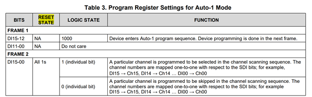

    From the manual, how do I know Table 3: Logic State is what I'm supposed to use versus Table 2: Reset State or Logic State?

  • To answer your first question, table 3 applies only when programming the channels you will be using in auto-1 mode. When you actually want to enter auto-1 mode and cycle through the channels, that's when table 2 applies. Table 2 also contains some configuration parameters, such as the input range, channel reset, powerdown mode, output data format selection, and GPIO control (when configured as outputs).

    What is the difference between Reset and Logic State?
  • Reset state would be the default values on power up or on a reset. Logic state is the bits that correspond to the instruction, i.e. the actual instruction word. So if you want to operate in auto-1 mode per table 2, your input word could look like 0x2840. Here, auto-1 mode is selected, writes to DI[10:0] are enabled, and 2*Vref input range is selected.
