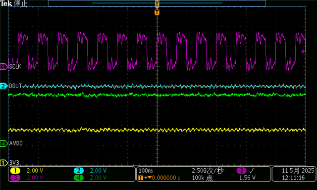

    So how is it verified that AVDD, DVDD, and clock are working normally during this scenario?

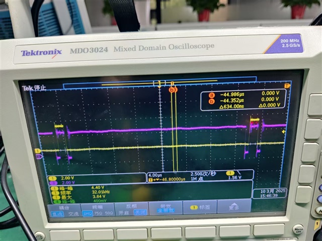

    Are oscilloscope pictures showing these signals and DOUT available during the fault?
       The AVDD DVDD DOUT waveform as below, the unstable waveform is due to the length of the test lead

    IC operating condition description: H-bridge topology currently intermittently opens the left lower bridge arm to continuously charge the AVDD of AMC0106. Our driving waveform is shown in the figure, with the red 3 channels being the GS waveform of the left lower bridge arm driving the H-bridge, and the yellow 1 channel being the GS waveform of the right upper bridge arm driving the H-bridge, with a frequency of 32K.

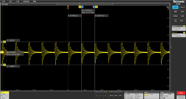

    It would be helpful to check exact AVDD signal by short probe ground or COAX connection across C33 to confirm the magnitude of the high frequency ringing.
    Assuming that this ringing on AVDD (either coupled or conducted) from the gate driver is causing this issue to occur, a snubber or capacitance multiplier on the AVDD circuitry to increase robustness of the AVDD line may be helpful.
    This would help from the AMC side, but likely best course of action would be to find the cause in the bridge circuitry for this ringing and try to improve settling.

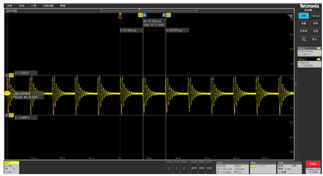

    2. short probe groud, The customer conducted a test using a spring needle, as shown in the following figure. AVDD
    The waveform after testing with an isolation probe. The peak value and amplitude may not be correct because the high-voltage isolation probe has a relatively large amplification factor and a small bandwidth.
    Add a 2.2 Ω resistor as a snubber and a capacitor of 4.7uF, but the problem persists.
    Thank you for confirming. This looks like the device is recognizing a missing high side supply.
    From the first waveform, the lowest voltage marked by the cursor would suggest AVDD = 2.719V - 1.499V = 1.22V.
    This is well below the minimum AVDD_UV detection threshold. The rapid change in AVDD voltage in combination with the repetitive nature of the undervoltage is likely causing this behavior in the device.
    Two things to try: Reduce the ringing as mentioned in my previous post and/or increase the settled voltage to be greater than 2.719V. Keep in mind that if this is done, then the over-shoot should not exceed the absolute maximum ratings of 6.5V. Keep in mind that the probe bandwidth may limit the true over/undershoot value and could be beyond what is captured by the scope (as mentioned in the HV probe picture).
