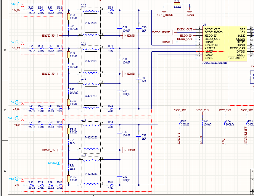

is there any alternative ic with 4 channel differential input , like AMC131M03 which omly has 3 differential inputs with digital output and isolation , looking for same configurations with 4 input chennals

I was plaing to use this IC to measure the 3Phase AC and DC voltages using tthe single IC
Do you have a diagram showing how you would like to measure this? My concern is that the AC and DC voltages may not be referred to the same potential. This could create a risk of damage to the device.

can go through this schematic diagram, how i planed to measured is shown in that, and
is it okay to do this way or can you suggest any alternative ?
Hi Manikanta,
This should be fine for the device, though there may be issues in your system if the DC bus and AC Line aren't fully isolated.
