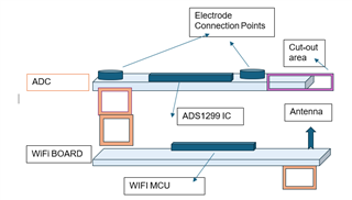

Im making a board with ADC ADS1299-4 and controller integrated WIFI functions.
One board for ADC and other board for WIFI controller, 2 boards were connected by B2B connector (height btw B2B conn is 2.5mm).
How are the best option for ADC parts placement to improve/cancel a noise/interference ?
*Opt1: ADS1299-4 placed on bottom layer board, near WIFI MCU
*Opt2: ADS placed on top layer board, near electrode
Thank you.
  • Hello Zuan,
    Option 2 makes the most sense, in my opinion. The AD1299 should be placed in close proximity to the electrode inputs. Having these components on the top of Board 1 will allow the bottom layer(s) to act as a ground shielding and reduce any potential noise coupling from the WIFI/MCU board.
    Ryan
