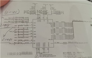

Dear Expert We use singel end input ,and use REF5020 as 2.048V ref voltage,now we test found that the offset error is too high.
And different IC could have different offset error.
Below is schmetic ,could u hlep to check how to prevent these offset error?

    If you disconnect the analog inputs and tie them together. Is the offset still too high? Remove R888/R889 for example. Then measure.
    If not, then the offset is coming from the circuit before the ADC.
    Using an external reference will not change or improve the offset, external references will only improve the gain error of the ADC.
    Rob

  • Hi Gabriel,
    so the results above are with the signal generator disconnected? And the input shorted together?
    Please see my pic below. Like this? Please verify.
    Rob

  • Hi Gabriel,
    The customer is still not giving me enough information to help.
    I cannot tell from the previous post if there is a problem still.
    The schematic is not correct, VREF should not be connected to VIN- and also connected to a signal generator.
    It would be very helpful for the customer to send details, block diagrams on how they are testing this.
    Rob
